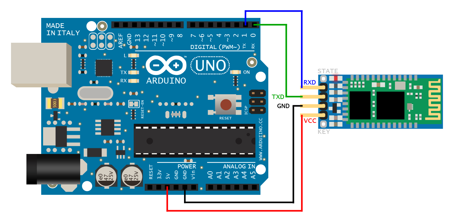

Thanks! Here is the schematic. It may be a little blurry. If it is, I can attach a higher quality version of it.
Hi
A few comments regarding the wiring schematic
  1. You don't need a a resistor in series with the pot if you don't need it as a voltage divider. In this setup you can never reach 0 volt to input A0-A2.
  2. One of the servos is connected to pin 8, but that is not a PWM output.
  3. You should use a 100 microF decoupling capacitor between + and - near the servos. You could have one across + and - near the pots also. It evens out any voltage changes caused by the components.
Yours /GG
