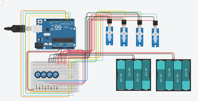

And here is a picture of my wiring diagram:
Breadboard isn't capable of handling large current. Power to the servos should be direct.
Ok, thanks for the suggestion. I will try that as soon as I can.
I rewired without the power running through the breadboard and it still didn't work. Any other ideas are greatly appreciated and I will try them as soon as I can. I also tried wiring in some capacitors and here is my wiring diagram for that.
This works well in the simulation, however it results in zero servos working.
Servo problems are almost always power related. Can you get one working with your battery packs directly powering it? Don't forget to connect the grounds.
I will test again with brand new servos incase it was somehow a problem with the servos. I'll repost later today with that result.
Why is there a resistor in the top leg of the pot? This will limit the range of readings the pot will give depending on the resistance of the pot itself. When using pots on an Arduino they should ideally be 10K.
