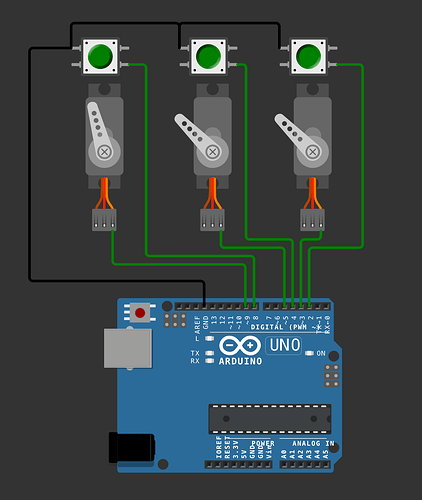

Hi everyone,
New to Arduino and here. I have been working on a model railway project where I am looking to control 3 different servo's with 3 different toggle switches. Switching the toggle on or off moves the servo to a set postion.
ie. Servo 1 controller by Toggle 1,
Servo 2 controller by Toggle 2,
Servo 3 controller by Toggle 3,
I have been using the following code for 1 servo/toggle but would like to expand it to what I would like. Is this even possible without any extra components?

I am not sure 100% what you are asking, if the question is can I have more buttons and servos, then the answer is yes, BUT you will need to use a library to use multiple buttons as it is somewhat advanced
Yes, no library required because you're using toggles, which retain the state until you change them.
So, 3 switches feed 3 inputs, 2 outputs feed 3 servos, and you're done. code to follow, in a minute or so
just mind bouncing... (you won't see it but the servo will get very fast asks to move to 45, then 75, then 45, then 75 etc.. it's so fast if the loop does not do much that the inertia of the servo will hide it)
DUH, of course.
Thank you, I've been trying my best to do it but end up making switch 2 control servo 2 and switch 1 doing nothing.
The following is the simplistic approach, which will do what you want but becomes a maintenance nightmare.

And, to avoid the contact bounce referred to, for your purposes right now, a delay(50) in the loop will suffice.
You can start with 3 servo variables and 3 servo variables; just number them (myservo1, myservo2, myservo3, buttonPin1, buttonPin2, buttonPin3).
Read a button, control the servo, read the next button, control the next servo and so on. You only need one buttonState variable.
The use of numbered variables is usually not advisable as it becomes a maintenance nightmare.
So in the next step you use an array for the button pins and an array for the servos. You can loop through the button pin array, read the button pin and based on the value you control the associated servo. Again, only one buttonState variable needed.
And in the last step you can use struct where you combine one button pin and a servo and use an array of those structs and loop through them.
wire the switches and servos just like a classification yard, then do the same for the code along the following line
if sw1 do sw 1
else if sw2 do sw2 etc
aaa thank you, I was so close I was just forgetting to put the different numbers after each servo here
myservo3.attach
Thank you I can see where I was going wrong with my code in camsysca example above. I was just missing a single number, so frustrating. I will look into what you suggest to simplify it next, I just needed to know it was possible. Thank you everyone

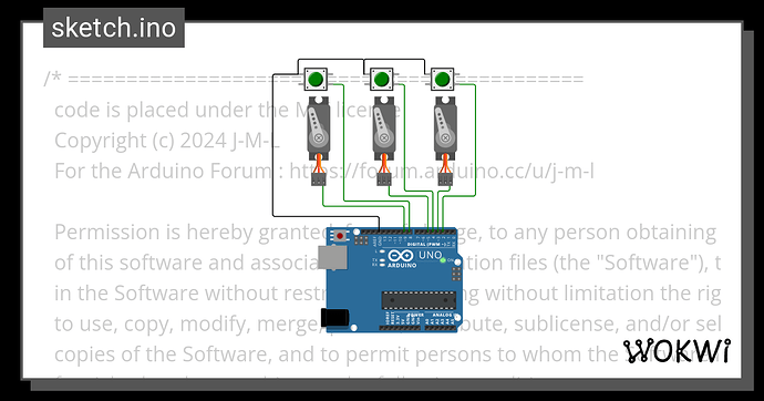

actually the last step would be a class and a method inside the class update the status. Would be very C++ :slight_smile:
here it is
click to see the code

#include <Servo.h>
class RailroadSwitch {
  private:
    byte togglePin;
    byte servoPin;
    Servo servo;
  public:
    RailroadSwitch(const byte togglePin, const byte servoPin)
      : togglePin(togglePin), servoPin(servoPin) {}
    void begin() {
      pinMode(togglePin, INPUT_PULLUP);
      servo.attach(servoPin);
    void update() {
      if (digitalRead(togglePin) == LOW) servo.write(45);
      else servo.write(75);
RailroadSwitch switches[] = {{2, 3}, {4, 5}, {8, 9}};
  for (RailroadSwitch& rsw : switches ) rsw.begin();
  for (RailroadSwitch& rsw : switches ) rsw.update();
  delay(50);
servo powered separately, joined GND, not needed for the wokwi simulation.
(wokwi does not have toggles so you need to cmd-click (on a Mac, possibly use the windows key instead of cmd) to keep the button down)
