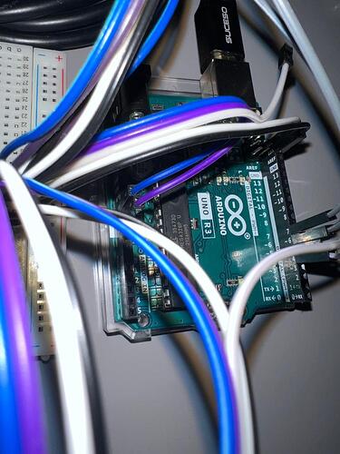

Multiple VL6180X, 4 sensors
Hello everyone, I'm new here and it's my first project with Arduino. I want to use the Adafruit VL6180X 4x. For this I use the example code VL6180x_tripled and added "everything" for the fourth sensor. But I always get an error message "Failed to boot third VL6180x". With 3 sensors and the example code VL6180x it works. I use the UNO R3 (see Image). Thank you very much in advance for your hints and Information.
