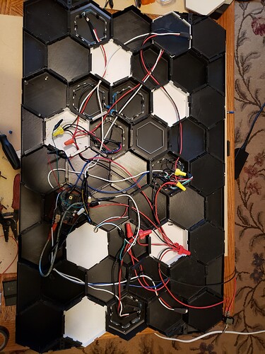

Hi, @xvmodvx
Welcome to the forum.
Not a cut and paste picture.
You do not have to show the complete length of each strip, just the start and stating what the strips are.
How are you powering your project?
Have you worked out how much current your LEDs require?
Thanks... Tom.... :smiley: :+1: :coffee: :australia:
I want to start off by thanking you guys for replying, when I woke up this morning I was amazed how many responses I received in under 24 hours and how much you guys are trying to help, so thank you. So at the moment I have all three running into a single wire and it connected into the one working PIN, but I would really like to figure out why I'm getting the results that I'm getting for future reference and help deepen my understanding.
to TomGeorge:
I'm uploading my terrible drawing of the circuit, hopefully you can make sense of it lol I'm using a 5V 10A power supply which should be more than enough, the numbers I listed in my code were rounded up some and I'm pretty much safe even if they all were at their 60mA max.

I'm uploading a screenshot. this seems to me to be the most likely cause besides just being a bug but what do I know
Again thank you guys
