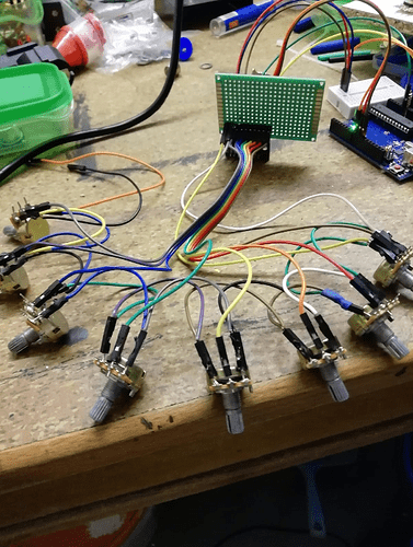

For my project i need a bunch of controls so i figured it would be good to use multiplexers and potentiometers.
The problem is: when i try to read the potentiometers, some of them fluctuate in value without touching the potentiometers.
When reading only one multiplexer channel over and over, without touching the potentiometer, the value changes from 0 to 1023.
I connected 8 poties to the channels of the multiplexer and use the vcc and vee as +5V and GND in parrallel.
Why do my values keep changing? Could the cables be loose ? - but then why is it reaching 1023?
My best guess is that i did something wrong when connecting them.

Though, some values remain constant and others just keep changing in the full range, not only a few percent. I cant seem to get anything close to a constant value for some poties... I guess I am looking for hardware solutions

Can't follow that wiring or see what components are being used. Can you post a schematic please? And your code. Please read the forum guidelines in the sticky post before you do that, so you know how to do it right.
You might try reading the analog pin twice after changing the multiplexer address, and discard the first reading.
If those connectors just push onto the pots it could well be a bad connection , you really need to solder to the pots.
A better wiring plan would be to have a board and bring all the individual 0v and Vcc connections to that “star “ fashion . Much easier to spot a fault . Also connect one at a time and check it works ok.

Thanks for your answers guys,
I cant upload a schematic..
but I put everything in a breadboard and it now works perfectly!? So it definetly is bad soldering at my part.
Which almost certainly means that the analog inputs are floating. That is the voltage on the wiper is not being switched through to the input. What do you get when you measure the voltage on the wiper of the pot that do this, compared with the voltage on the analogue inputs.
