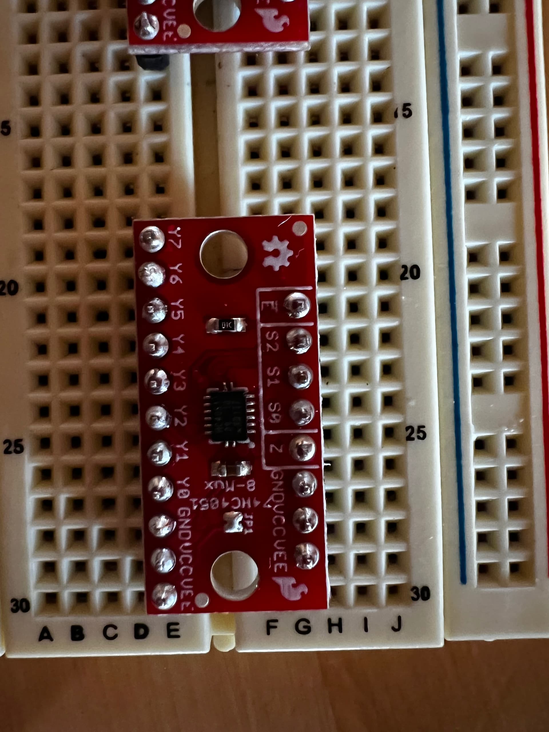

Hi folks, I am using an Arduino MKR WAN 1310 with a multiplexer (74HC405). I want to connect several sensors to the multiplexer, but, I want each sensor to have a controllable supply voltage. Like to turn the sensor supply on and off. Now I tried connecting a simple temperature sensor to the MUX using the 5v supply from the Arduino to power the mux and then used the mux output supply voltage vcc and gnd to power the sensor and have the sensor wire to the input of the mux, it worked fine (along with other sensors). But I want to control the sensor supply voltage. I tried to connect the sensor supply wires to two digital outputs of the Arduino (3.3V) with the signal still going to the Arduino, but I got rubbish sensor readings. Do I need to use the same supply from the MUX to drive the sensor? I also tried driving the MUX itself from two digital pins (High and Low) that way I could just turn the MUX on and off and therefore the sensors, but this did not work either, again rubbish from the sensors. Any help would be greatly appreciated, thank you.
In summary I would like to use a MUX but have my sensor supply controllable from two digital pins whilst having the sensor line connected to the MUX.

So the working setup:
Vcc and Gnd at 3.3V and 0V respectively from the Arduino to the Vcc and Gnd pins of the Mux (same side as the select pins S0, S1 and S2). The sensor power comes from the other side of the board, pings Vcc and Gnd , same voltage and on the input side. Each sensor line (they are 3 wire devices) goes to a pin Y0, Y1 and Y2. The analogue output of the MUX, Z, goes to A1 of the Arduino. All works as expected.
Now I keep the code the same except this bit:
I want to power the sensors from digital pins 0 and 1 from the Arduino, instead of the Mux. So I connect the input Vcc and Gnd lines from the Mux to pins 0 and 1 of the Arduino - no longer using the Arduino Vcc and Gnd pins.
In the code I wrote:
pinMode(0,Output)
pinMode(1,Output)
Then I start these both off low.
digitalWrite(0,Low)
digitalWrite(1,Low)
Then In the loop I write:
digitalWrite(0,High)
Then the sensor bit same as before.
And then after a delay I set the line Low so
digitalWrite(0,Low)
and although the output pins do give 3.3V when set High (I measured with a multimeter), the sensor values are just rubbish.

I want to use an output channel of a multiplexer to provide the supply voltage for my DS18B20 temperature sensor. I tested the MUX by itself, I have it set to output 3.3V for 5 seconds before setting it low to 0V. This checks out with a multimeter.
I now connect the positive supply wire of my DS18B20 sensor to the output channel (channel 7) of the MUX and connect the negative wire to the ground connection of the MUX. Giving the sensor 3.3V supply.
I have set analogue channel A1 to read the sensor (worked fine in the past without MUX), but all I am getting is -127 or sometimes 85 from the serial console.
Any help would be appreciated, thanks.

I fixed it guys, I hope this helps someone else. Instead of using the analogueWrite, it should be digitalWrite(pin, HIGH) and then digitalWrite(pin, LOW)
Why the heck do you want to do that for a sensor that draws less than 1uA.
The muxer itself could draw more than eight sensors.
Leo..

For EMC purposes I want to isolate both the power and ground lines of each sensor. The two Mux’s allow me to do this, one provides the positive through a pin set High and the other MUX provides the ground or low pin voltage. Therefore there are no shared ground lines between the sensors, this is more important for electronics in electrical noisy environments where the sharing of ground lines can cause interference leading to misleading sensor readings and inaccuracies.

You seem to think that a muxer is the same as a mechanical switch, which it is not.
Sensor potentials must (and will) stay within the boundaries of supply and ground, so no full isolation with an open switch, also because of the muxer's build-in clamping diodes.
I don't know why you think a common ground for buried sensors is bad.
The sensor itself is (should be) only grounded to the Arduino, not to mother-earth at the sensor side.
I assume you use a "waterproof DS18B20", which is not waterproof.
The metal tube is also not connected electrically to the sensor.
Leo..
I don’t think a Mux is like a mechanical switch.
In the event of nearby lightning strikes, where sensors are buried in the ground, induces currents can flow through the ground, between the sensors and interfere. One method to avoid this is to isolate the grounds. This can be achieved using multiplexers.
I wanted to use on as a demuxer, select the channel output which will output a high pin voltage, the other end of the sensor will output a low pin voltage as shown in the screenshot above, this works for the temperature sensor. The readings are accurate as they were verified by another temperature sensing device.
So you still think it behaves like a mechanical switch.
There is a pair of internal (clamping) diodes from each muxer pin to VCC and ground of the chip.
Any voltage greater than VCC +0.5volt and GND -0.5volt will just blow through the muxer.
