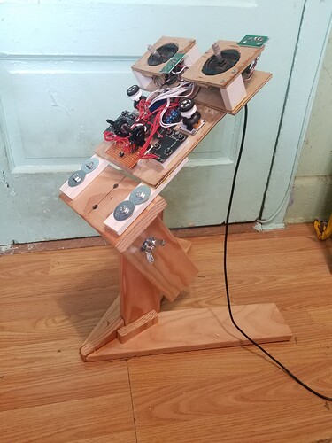

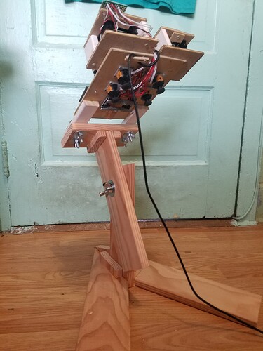

The project is "completed" and in use. It is a game controller with a bunch of joysticks, for use in space games and other flight simulators and FPV simulators. It works well, except the connection to the pc is shaky. I don't know why, but it failsafes (an aspect of the vjoyserialfeeder app used to connect to the pc) a lot, forcing me to "disconnect" then "reconnect" in the app to bring it back.
Is it possible that the arduino is not running smoothly because I have too many loads on the 5v? If so what can I do? I have a similar project that is smaller, only 4 joysticks, and no additional potentiometers, it never has this problem. (sometimes I bump the usb connector, but it's a different situation, and it's just that I wore out the usb connector by now).

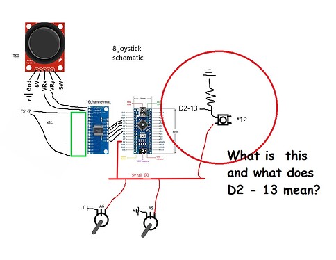

Maybe its a power issue. Try running the Arduino from an external power supply.
Wow thats an impressive project:
I'd suggest
1: tidy up the wires
2: your buttons are wired with pull downs - but you havent shown the value.
They would be better wired connected to ground, using the arduino's internal pull-ups.
3: you havent shown the resistance of the joysticks (or a link to the parts used)
4: I dont see any decoupling.
they're 10k. I was under the impression there wasn't such an internal pull up option, at least with the nano? So I would run a wire from the nano, to the button, then to ground. I feel like I would have seen this elsewhere by now, in a tutorial or something. perhaps it is a newer feature?
I don't know where I should expect to put decoupling? I'm not very knowledgeable.
most of the sticks are also 10k. The big sticks are 5k, as are the wipers.
yes,, the wires are all over the place, but I've really reworked the solder joints a lot, and feel pretty good about every contact and that the wires also have good integrity.
I am reassured by so very many that a motherboard usb 5v should be more than adequate for any number of potentiometers on a thing like this, but I am wondering if perhaps my issue is not the power coming from the computer, but instead there is a regulator before the 5v rail, and my issue is from the load after this regulator, if indeed it does exist??
There is a regulator but because the arduino is being powered via USB, it’s not going through the regulator. If the pots need 5 volts then they should get that from an external source. Just make sure the ground of that external source is connected to the arduino ground too, otherwise you may get weird results.
Reasons not to use switches conected to the + supply:
decoupling refers to capacitors placed across the supply rails to prevent sudden changes in supply voltage.
Well, there is.
What is this circled?
Can you please post a picture of a hand drawn circuit in jpg, png?
It will be easier for you and easier on us.
I cannot see any supply or gnd to the multiplexer.
there's the same 5v and gnd to the mux as everything else.
D2-13 are pins on the nano, and that's the basic button diagram that goes to each of them.
How are you powering your project?
Do you have a DMM?
What do you get when you measure the voltage between the 5V pin and gnd pin on the Nano.
What is the resistance of the pots in the joysticks?
If you are using the USB power, how long is the USB cable?
HOW you connect the ground to the mux will affect your readings. The grounds for the inputs (your 8 joysticks) and the mux and nano should be a star point.
However thats unlikely to cause your issue.
Can you run a MUCH simpler sketch to see if it still failsafes? Omit all the analog readings.
4.9v from 5v to gnd, but 4.6 at vin.?
my other project is 4.6 everywhere.
