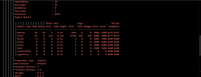

sweat_smile: ok sorry for that now I ticks them and it show me error
it is better see the error from the screenshots
The error where you can copy it.
FQBN: arduino:avr:uno

"C:\Users\Ahmed\AppData\Local\Arduino15\packages\arduino\tools\avrdude\6.3.0-arduino17/bin/avrdude" "-CC:\Users\Ahmed\AppData\Local\Arduino15\packages\arduino\tools\avrdude\6.3.0-arduino17/etc/avrdude.conf" -v  -patmega328p -carduino "-PCOM6" -b115200 -D "-Uflash:w:C:\Users\Ahmed\AppData\Local\arduino\sketches\441CD5E6AFD18EE6702CA2A8C2277DFA/sketch_feb13a.ino.hex:i"

         Programmer Type : Arduino
         Description     : Arduino
         Hardware Version: 3
         Firmware Version: 4.4
         Vtarget         : 0.3 V
         Varef           : 0.3 V
         Oscillator      : 28.800 kHz
         SCK period      : 3.3 us
Reading | ################################################## | 100% 0.00s
avrdude: Device signature = 0x1e950f (probably m328p)
avrdude: reading input file "C:\Users\Ahmed\AppData\Local\arduino\sketches\441CD5E6AFD18EE6702CA2A8C2277DFA/sketch_feb13a.ino.hex"
avrdude: writing flash (1466 bytes):
Writing | ################################################## | 100% 0.20s
avrdude: 1466 bytes of flash written
avrdude: verifying flash memory against C:\Users\Ahmed\AppData\Local\arduino\sketches\441CD5E6AFD18EE6702CA2A8C2277DFA/sketch_feb13a.ino.hex:
avrdude: load data flash data from input file C:\Users\Ahmed\AppData\Local\arduino\sketches\441CD5E6AFD18EE6702CA2A8C2277DFA/sketch_feb13a.ino.hex:
avrdude: input file C:\Users\Ahmed\AppData\Local\arduino\sketches\441CD5E6AFD18EE6702CA2A8C2277DFA/sketch_feb13a.ino.hex contains 1466 bytes
avrdude: reading on-chip flash data:
Reading | ################################################## | 100% 0.20s
avrdude: verifying ...
avrdude: verification error, first mismatch at byte 0x0000
         0x62 != 0x0c
avrdude: verification error; content mismatch
avrdude done.  Thank you.
Failed uploading: uploading error: exit status 1
Hi, @ahmed_alhajri321
Can you please post your entire code?
Thanks.. Tom.... :smiley: :+1: :coffee: :australia:
  Serial.print("Hello World");
So your code is not uploaded. Except for a damaged 328P processor I have no idea why.

Hello guys sorry to be late for responding but I solve the Problem. I take the arduino to store and told him about the problem. He replace only the Microcontroller with a new one now it is working. Thanks for your times
