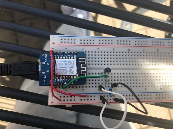

I've tried almost everything but the sensor is still showing -127 degrees. No matter which diagram or code i use it doesn't change anything at all. I downloaded the libraries and used diagrams with and without resistance. I also tried using 2 temperature sensors because my professor said so. I tried using analog pins as well as digital ones. Still nothing works.
Here's the code I'm currently using:

How have you wired up the sensor and which board do you have?
Hey, thank you so much.
I use the ESP8266 Board

There should be a resistor in there somewhere. Have a look at ESP8266 DS18B20 Temperature Sensor with Arduino IDE (Single, Multiple, Web Server) which should show you how it's done.
I used the diagram and code and it's still not working :frowning:
Your sketch with little modification is working fine with my ESP8266 based NodeMCU.

1. Connect Data-pin of sensor with D4-pin of the board.
2.
(1) Change this line: int oneWireBus = 3; to the following:
int oneWireBus = 2;
(2) Use direct one jumper for one connection.
(3) Use 2.2k to 4.7k resistor between Data-pin and Vcc (3.3V).
(4) Do not use TX (GPIO-1) and RX (GOPIO-3) pins of the ESP8266 as they are engaged with PC/IDE/SM.
(5) Pin diagram (Fig-1) of DS18B20 temperature sensor.

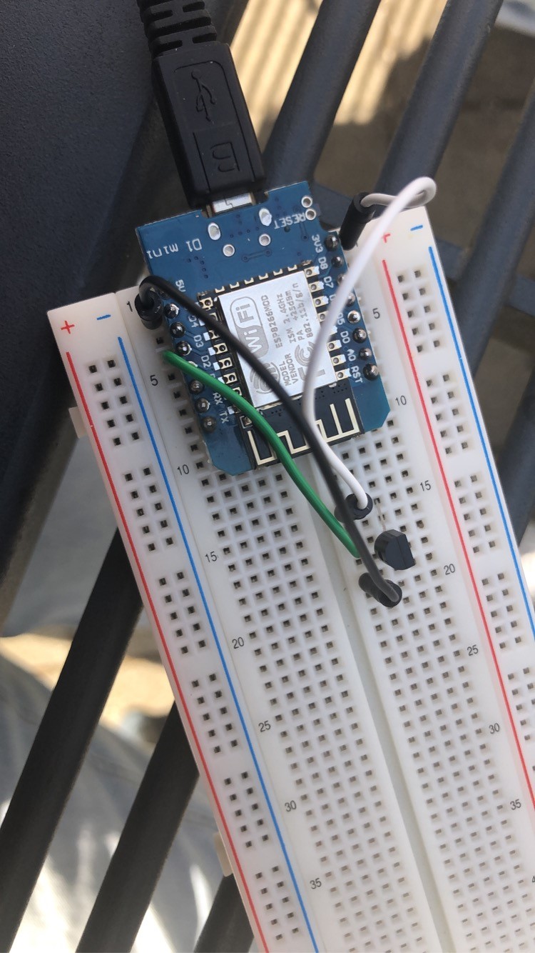

Your photo doesn't match the pinout that @GolamMostafa shows above. You've got the sensor comnected wrong.
I have connected sensor at D4-pin (GPIO2). I have suggested OP to do the same thing.
