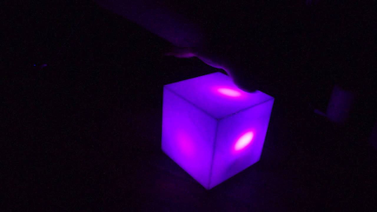

Hey folks, if anyone's interested, I've just finished this lamp for a uni project.
What do y'all think?

Hai, I am new to this website so I don't know anything about the hardware, but maybe I can give you a tip if you want to use this project for future designs. I think that you should make it round. Now you can see that specific colors give a darker stripe on an other place. Ofcourse you can rotate the stand itself, but in these times. Humans are lazy.

Well done, (is this a repost as I've see this video a few days ago)
Can you post your code ? tech details? or is it private project?
I expect compass module + RGB led (angle => color ) clever trick.:)
Thanks folks. I know the light dissipation isn't perfect (if that's what you mean by darker areas), but there's a battery pack inside on the bottom, so it is a lot darker there - needs more development to solve that problem.
And yes, it uses a HMC5883L compass module, arduino uno, piranha RGB led and NiMH battery pack.
I won't put the code up yet as it's a uni project that hasn't even been marked yet, but am happy to share it at a later date for those interested, as this site was very helpful when creating the lamp :)

mirrors or lenses can do nice jobs (paint the batteries with mirror-paint.

But the problem is that the batteries take up most of the bottom of the cube, so I'd need clear batteries lol. Ideally, all the internals would be suspended in the centre, but I didnt have the time or resources to do that really..

Just out of curiosity, why did you use the compass module instead of mounting it on a potentiometer(like this https://www.sparkfun.com/products/11173)? Wouldn't that be a lot cheaper? I guess you couldn't turn it more than 360 degrees though.
with a compass you can also walk with the lamp and it still works...

How many LEDs are inside? I plan to rebuild this and thought aboud buildiing a frame of transparent acryl glas to put the battery pack in the center of the cube., so you won’t get a dark are on the bottom.
also what do you think about using a QI charger to load th battery pack

I finished my first version: https://www.youtube.com/watch?v=k5b_B8uJdUw
i have to rework the illumination and to optimize the color steps, but this ist not really a problem.
The color steps and the illumination are now optimized:
https://www.youtube.com/watch?v=_SttvEHUjdI (the left cube already has the optimized illumination.)
if you guys are intressted, i will release my sourcecode and a partlist in the next weeks.

In the Archive you will find my source code and my fritzing file for the pcb which i use to boost the pwm signal.
