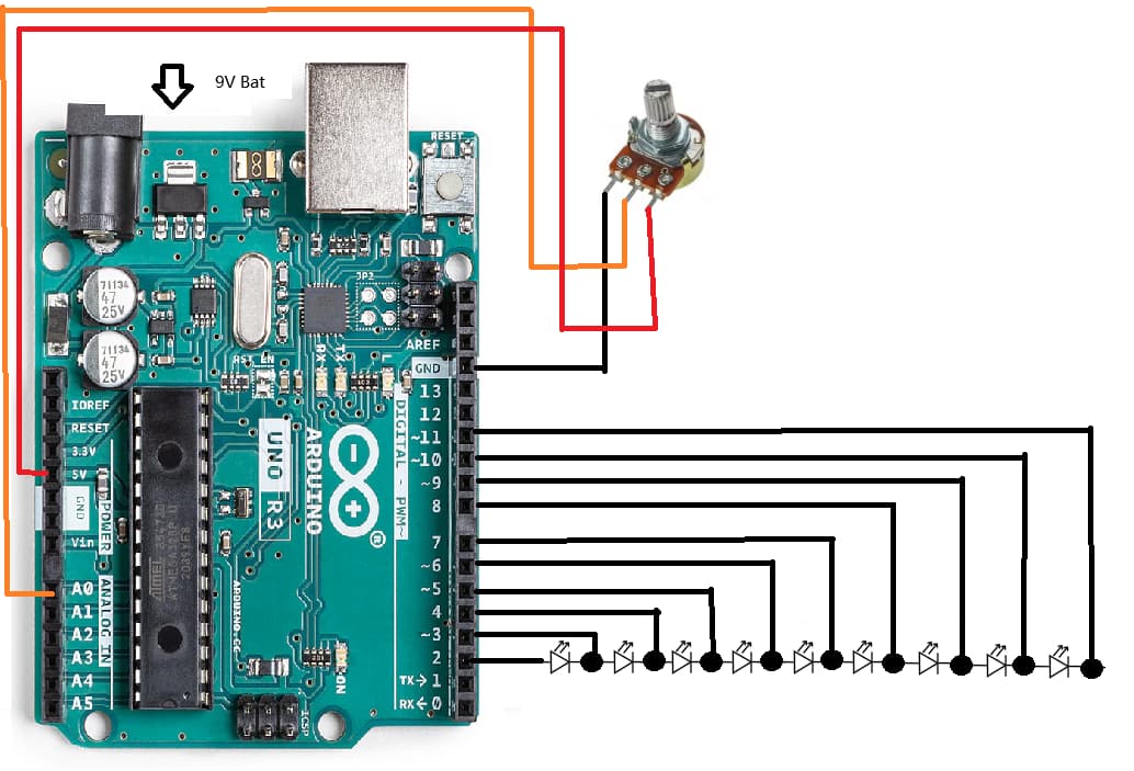

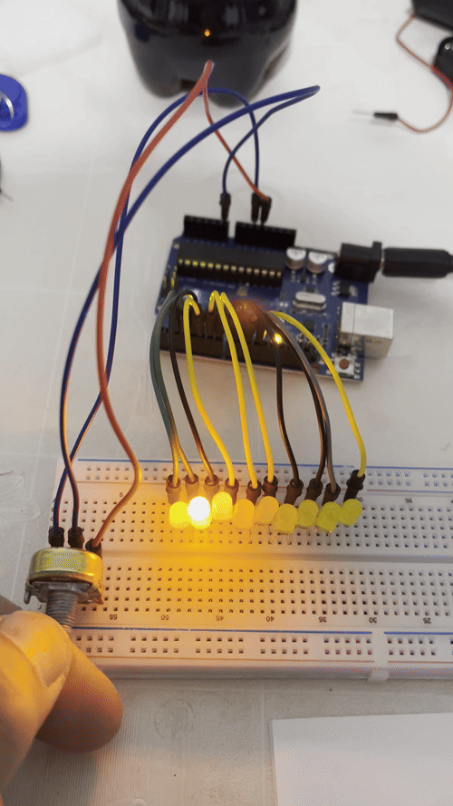

My kid created a new design of "LED Bar Graph"
My Kid is now learning Arduino, he got a new Uno R3 starter Kits, and after I show him the example code of "LED Bar Graph", he played with the LEDs and give me a new design, and I couldn't explain how it works like that.
ezgif-7ec2667d431b05
If there are no current limiting resistors for the LEDs, as the diagram indicates, you can expect the port output pins to fail, sooner or later. The LEDs may fail sooner.
The rule for that Arduino is that the output pin current should not be allowed exceed 20 mA, which also happens to be the maximum safe current rating for most common LEDs.
Judging from the brightness in the video, the LEDs are in the process of burning out.
  • As mentioned, common LEDs require current limiting, add a series resistor on each LED.
    Or, buy a new Arduino soon. :weary_face:
  • When a GPIO is LOW, there would be 0V on one side of a LED, a GPIO on the other LED pin set to a HIGH, turns ON the LED.

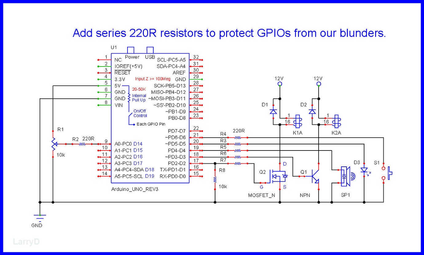

  • When starting out with the Arduino hobby, suggest you always add a 220R resistor in series with all GPIOS, that’s all.

Just add >100R resistor to every pin, and you cam play safely

This is certainly the way the circuit appears to have been drawn although it is not the obvious way of connecting multiple leds to an arduino.
Since only one led is lit at any one time, the circuit could be restructured so all the leds cathodes are joined together and that common cathode could itself be joined to the ground power rail via a single say 330 ohm current limiting resistor.

OK. Looking at that it is now clear that what appeared in the OP was not exactly a "Bar Graph" and more of a single position indicator, which of course also has its uses. In a real bar graph, say a VU meter or similar, multiple leds are on to form a bar whereas that in the OP could show only one led at a time.
If you set first pin high, second one high impedance and third low, it would likely give LEDs on-on-off... (repeated 3 times).
