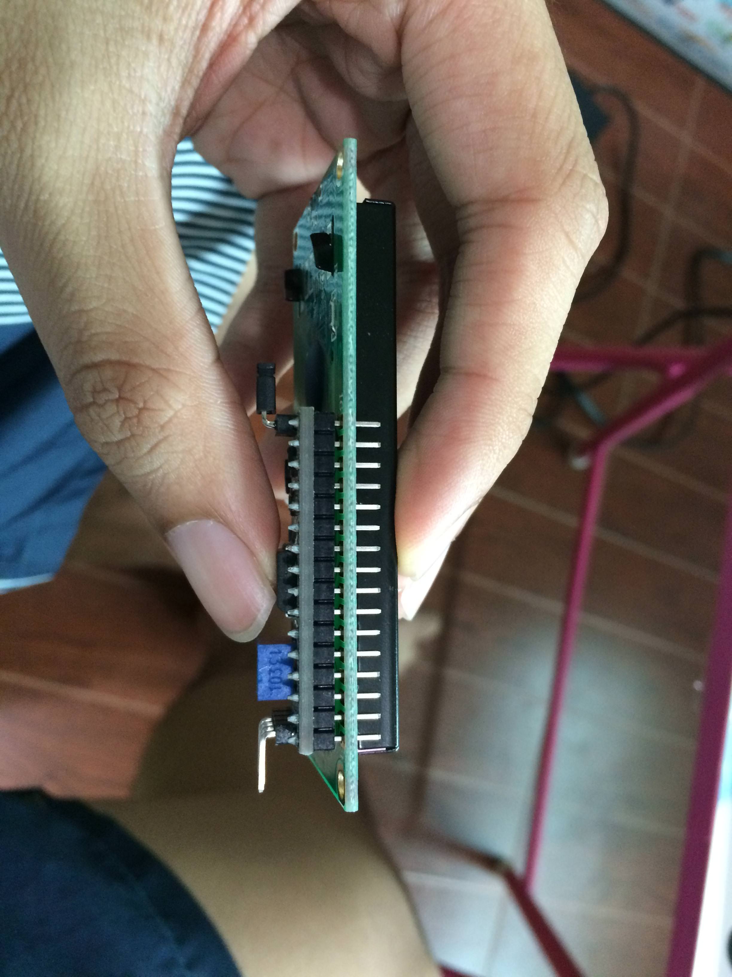

My LCD Qapass with MH i2c does not display text.
this is the i2c i used. i2c
this is the LCD i used LCD
The code i am using is from sunfounder

The picture of the connections. pic
I can turn on the backlight. I already tried to adjust the pot. The text does not display.

Can you please help me? thank you
more than likely soldering issues.
Can you post a photo of your device showing the soldered pins of the backpack to the LCD so we can take a look at the soldering of the pins.
BTW, the backpack is normally soldered to the back of the LCD PCB vs the same side of the PCB as the LCD.

Thanks for your feedback. Right know the device is under warranty. I think soldering it would make the warranty null and void. I would like to know if it works first before I solder. I have tried this on other LCD before and it seems to works even though it was unsoldered. Is there a way to solve this issue without soldering?

Okay i will solder. Btw is their a difference if i solder the i2c face-up or at the back.
You can solder it either to the LCD side of the PCB or the backside.
What matters is that pin 1 of the backpack header connects to pin 1 of the LCD PCB.
Usually, the backpack is soldered to the back side of the LCD PCB as it is out of the way.
Your original photo shows the orientation for the top.
Here is photo for the back.
When on the back, the LCD will sit a bit angled when resting and creates a nice viewing angle.
For a quick test you could put the backpack on the back side of the LCD and try to wedge something non conductive under it to hold it in place. It doesn't have to be lots of pressure but it does some pressure to hold it in place.
That might create good enough connections for a quick test.
But like I said, soldering is the way to go as when done properly, will ensure good connections that won't ever come loose.

does it supposed to have a gap in between lcd and i2c as i place it flat, naturally. is the tilt okay?

If you want to do a quick test, you need to put something between the backpack and the LCD PCB to lift up on the backpack to create a small amount of pressure on the pins.
When soldering it, you have to make sure nothing shorts out and try to keep the backpack level/parallel with the LCD PCB.
You will need to put something there temporarily to keep the backpack parallel with the PCB and to act as a spacer to keep the backpack from touching anything on the LCD PCB. Be careful of the metal tabs holding the LCD frame.
While isn't absolutely necessary to keep it level/parallel with the LCD PCB it looks better if you do.
The main thing is you don't want the backpack touching anything.
You do not want to solder it the way it is angled down in the photo as it looks like the backpack is touching either the metal tab or the LCD PCB itself.
That can create a short.
--- bill
On several of my LCDs, there is a gap to create a space between the backpack and the PCB and to shorten the amount of pin sticking out of the hole on the LCD PCB.
It can easily be about 3mm gap of metal showing between the LCD PCB and the black plastic on the header of the backpack.
On others, the chip on the backpack rests on the black blob on the LCD PCB which creates the needed spacing.
--- bill
the blob on my lcd is a bit short. the i2c cannot rest on it without creating an angle or touching a part of the lcd. what can you recommend as spacer? is paper okay?

CPU ARCH: AVR - F_CPU: 16000000
A4: digital pin: 18
A5: digital pin: 19
SDA: digital pin: 18
SCL: digital pin: 19
Checking for required external I2C pull-up on SDA - YES
Checking for required external I2C pull-up on SCL - YES
Scanning i2c bus for devices..
i2c device found at address 0x27
Total I2C devices found: 1
Scanning i2c bus for all lcd displays
LCD at address: 0x27 | config: P01245673H | R/W control: Yes
Total LCD devices found: 1
LCD Display Memory Test
Display: 0
Walking 1s data test: PASSED
Address line test: PASSED
Each working display should have its backlight on
and be displaying its #, address, and config information
If display is blank, but backlight is on, try adjusting contrast pot
If backlight is off, wait for next test
Blinking backlight test: to verify BL level autodetection
If backlight is mostly off but
you briefly see "BL Off" on display with backlight on,
then the library autodetected incorrect BL level
and the library cannot autoconfigure the device
Displaying 'uptime' on all displays
the Walking 1s data test and Address line test is now PASSED
as opposed previously that it failed.
However, i tried to show text on display but no text appears.
What do i do next?
bperrybap, thank you so much. I very much appreciate your help. it is now working. the last thing I did was adjust the pot. This keeps me motivated to learn more about arduino.
Imgur
Yea! Congratulations. It looks like it is all working now.
--- bill
