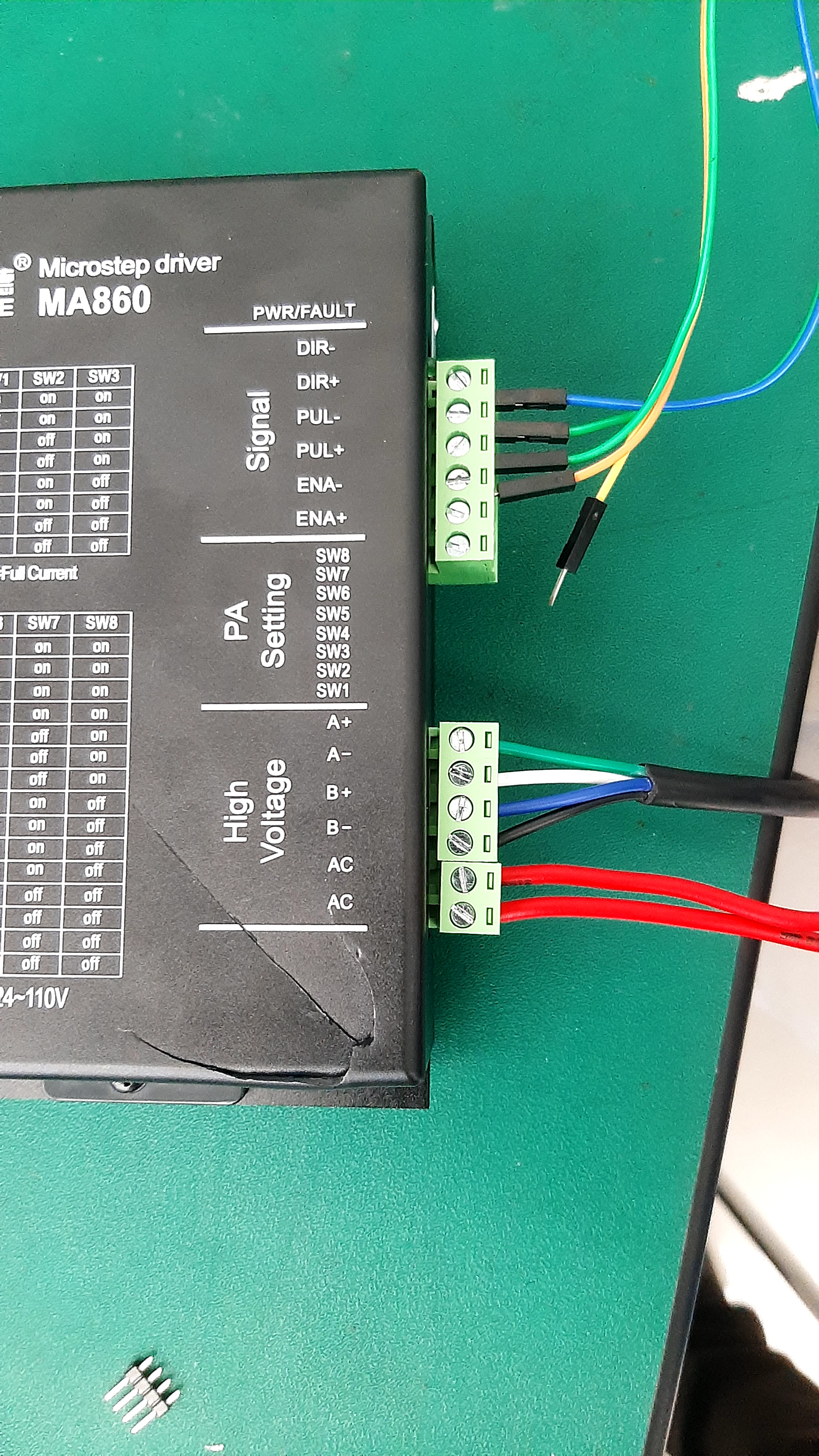

I'm trying to use a NEMA 34 stepper motor with the current setup and coding attached below, and it won't turn on with a 32V 3.2A DC supply. Any idea what I'm doing wrong? Or is the power not enough, or is the driver not working? The 9 pin is connected to the PUL+ pin and the 6 pin is connected to the DIR+ .

You will get help a whole lat faster if you make a block diagram of your setup, including the power supplies and draw lines representing the wires. Identify where the ends of the wire are connected.
Has the crushed case on the driver, near the input, effected distribution of the input?

What do I check in order to check for the input distribution?
When looking for problems in a circuit (anything really), the first step is physical inspection. Inspect the broken parts for more broken parts.
what is the motor rated current?
Do you need to make connections to the ENA+, ENA- pins?
