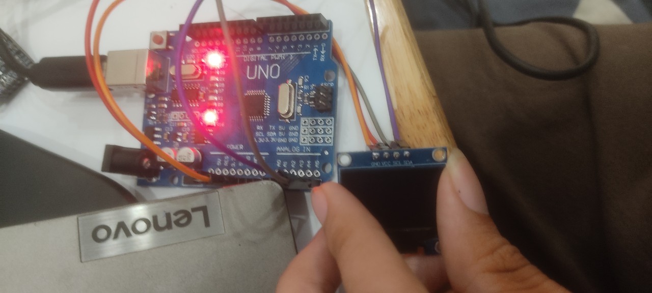

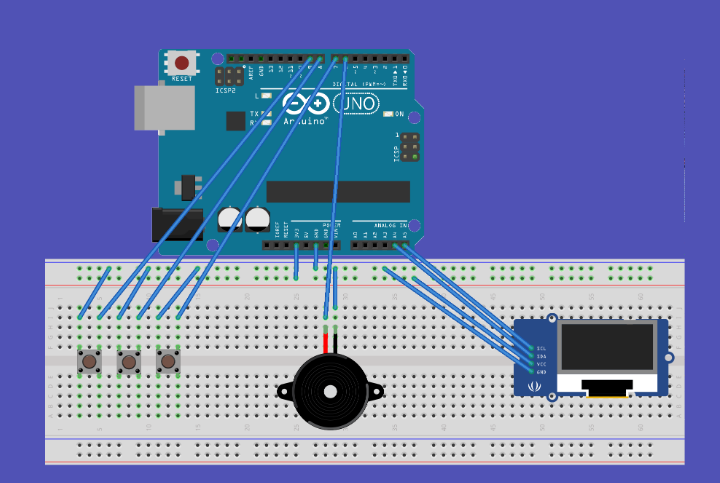

My Oled is not working... need help?
I tried to write the code for my Arduino Uno to execute the tamagochi program, but the screen doesn't show up, there isn't any sound, and the buttons don't move, but when I disconnect the screen, there is sound, and every button press works.

My circuit is built on this.
Your wiring is ok I think.

Do you have SDA & SCL wires swapped? I cannot tell from your diagram, the pin labels are blurry. A schematic would have been clearer.
Disconnect the OLED and run i2c scanner to check that it runs correctly and reports "no devices found"
Do you have any other i2c devices to test? Like an RTC or a sensor of some kind?
3,3v/5v to VCC(red)
gnd to gnd(orange)
sda to a4(purple)
scl to a5(gray)
Test all your Dupont cables. They are unreliable.
You're right. My Dupont cables are having trouble. Thanks for your help.
