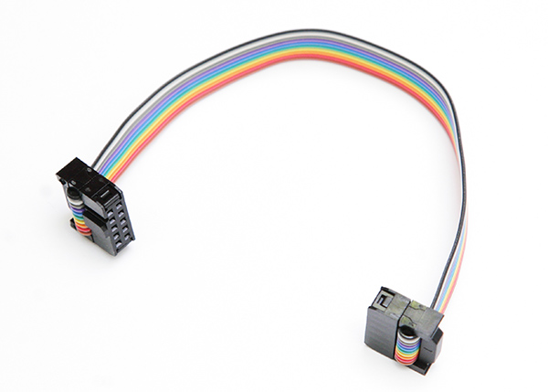

I have a dilema. I assumed (I know, I know) that an IDE cable would be one to one for every pin. It turns out that this is not the case with the 80 conductor ribbon cable version of an IDE cable. I have 40 pins from a shield that I built that I need to connect to another 40 pins on a TFT display.
Can anyone point me in the direction of a female to female cable that is 40 pins (with the standard header spacing)? Or a good way to connect the two devices without single strands?
The female connectors have "teeth" in them, that puncture the insulation of the ribbon cable.
That's why they're called "IDC", for Insulation-displacement connector.
So all you need to do is align them, then snap the bottom and top part, letting the "teeth" dig into the insulation and make contact with the conductor. No soldering needed.
You can buy these kind of female connectors from http://www.phoenixent.com/
For the cable, you can try eBay or mouser/digikey.

In the progress of building a 5x5x5 led cube I decided to use a 40 pin ribbon cable to make the connections from the standalone logic board to the led array. I used a 80 conductor cable assuming the 40 extra ground conductors would be no big deal as long as there was a one to one relationship to the 40 pin connector pins at each end.
Bad assumption as the ground conductors connect to several pins on the connector and one ends up with not having 40 isolated conduction paths between the two connectors, but rather several shorted together paths, as there is not a single 'ground pin' assigned to those 80/40 cables. I at first though I might have miswired several connections to the mating connectors but after just replacing the ribbon cable with an older 40 conductor/40 pin ribbon connector I found all the problems were solved.
The thing with the 80/40 cables is that all 80 conductors are electrical connected in the IDC connector and there is direct electrical connections made between all of the 40 'ground shield conductors' with several of the 'primary' 40 pin connection pins, so one cannot use it as a 40 independent conductor cable.
I probably could word that better, but it gives me a headache just remembering about the troubleshooting problems I had with that cable when I was building my led cube.
Though the number of wires doubled, the number of connector pins and the pinout remain the same as 40-conductor cables, and the external appearance of the connectors is identical. Internally the connectors are different; the connectors for the 80-wire cable connect a larger number of ground wires to a smaller number of ground pins, while the connectors for the 40-wire cable connect ground wires to ground pins one-for-one.
