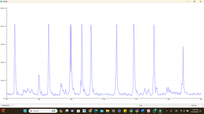

Hey everyone. Currently using the EMG Myoware sensor connected to ESP32 with the ENV output but I noticed that the output kept being inconsistent each time even when I am making the same gesture.
For example, when I flex, this one the output is between 1500-2500

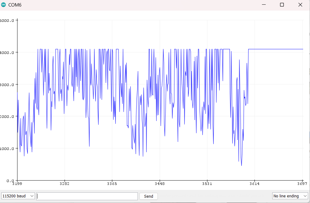

But after some time the output suddenly became around 5000 and does not react to my flexing. This had happened a few times and I am not sure what is wrong.
There's also some cases where the output is much more higher up to 4095 like this one. I am a little confused about which range of value is the right one?
The circuit is something like this and I had connected the optional reference cable and even cut the jumper trace.
The code is just simple of printing out the values. Connected to pin 27 instead of A0 like the example.

If there's anyone willing to give advice it is greatly appreciated!!
