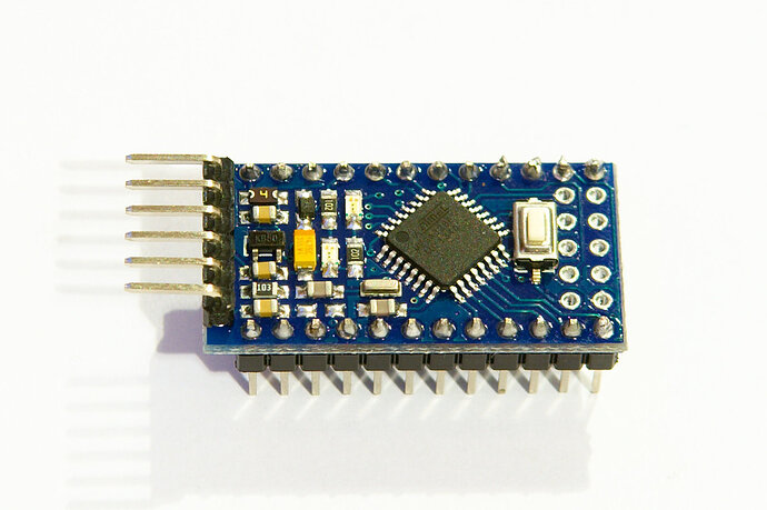

Hello all,
i'm a complete noob on arduinos, but quite good on raspberry
Now, i couldn't resist a ebay offer for an "arduino pro mini 328 compatible" (i had to look for the "compatible" lol), so i got one of these
i soldered headers, installed arduino ide, took my usb2serial adapter (with no reset pin.. a pl2303hx) and tried to flash the easiest sketch.
The "small thing" is flashing a green led every second, so i'm assuming a bootloader is ok on it.
  1. tried on my windows laptop.
got 10 tries of "programmer is not responding", "not in sync" and a random hex resp.
  1. tried with one of my raspberries.
I tried with any reset button press i could think about. Short, long, now, then, in the middle, everything :slight_smile:
now, what can i do? :slight_smile:
(i fear you'll say "write the bootloader".. i don't think i can do that with only a usb2serial adapter, right?)
Thanks :slight_smile:
"with no reset pin"
You'll need to press reset on the promini to kick off the bootloader.
In the IDE, select File:Preferences and enable Verbose Outputs.
Start the download - when you see "Compiled xxx of 32xxx bytes" press reset. May take a couple tries to get the timing right.
Hello CrossRoads,
i already tried all of these, sadly..
but
just to leave nothing to luck, i tried using the TXD and RXD not on the front header, but on the side one
AND IT WORKED
this is so stupid.. but i'm ok with this :slight_smile:
sorry for wasting your time..
Buzz them out, see if they're connected. If not, that's a design flaw.
