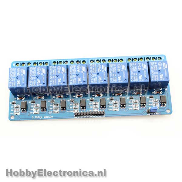

After going through some trouble with the relay module (and 74HC595) I finally have it working. Now I want to get it working with the IOT Cloud, and am running into a hurdle again.
When the Nano 33 IoT loads a new sketch or restarts all 8 relays switch on and off (once) in the blink of an eye. The relay module switches on with LOW, and stays off with HIGH. I've tried all the things I could find in other topics but nothing has worked so far, and I'm at my wit's end :frowning:
The OE pin is tied to ground, and so is the latch with a 10K resistor. There is a 0.1 uF cap over VCC and GND and the 595 is powered with it's own power supply. I've tried connecting the relay module directly to the arduino, or with isolated power supply like this picture. For that I've soldered the 2 contacts on the undersude to get 5V from the USB to the 5V pin on the nano.
I've tried setting the pinModes in setup to high but it doesn't help. At some point the relay module just started going nuts on/off continuously untill I pulled the power. I think this might be related to the power from the USB-5v pin. edit: or not because it also happens when uploading a sketch while powered externally.
Is there something I'm overlooking or is this a result of the way it's wired?

i would not take one single relay module to cap power of "8-way"-module before initialisation.
i would not use additional NPN or N-channel transistors to invert logic.
i would cut wires on module PCB and make it active HIGH.
is that possible with this module?
I've seen this module advertised with HIGH/LOW setting but I take it the "level trigger" is not the same as HIGH active?
they are mostly made like this
remove jumper.
desolder resistor R1/R4/... or cut wires between them
grond all IN pins
connect +power to "ry-vcc"
anods of opto with resistor(you may replace LED or take one additional) connect to outputs of 595 IC.
cut copper at place shown in red
strip some copper where S2/S4-S8
595 IC Q0-Q7 output pins to S1-S8
remove jumper
all input pins solder to GND
+5v to JD-VCC
arduino GND to GND
Show us the schematic of this.
If you make the relays active high they will turn on when you reset your Arduino. The active low solves this problem. When using MOSFETs most add a pull down resistor to guarantee the relay state until setup gets control. You can use the OE\ and turn it low when everything is set, that will enable the shift register to assert its outputs.

Connect the 595 OE to an Arduino pin, make OE HIGH at power up/reset time (disabling the 595 outputs).
After sending the relay levels to the 595, make OE LOW to operate the relays as per what you sent.
Does your red LED have a resistor ?
I'll try with the OE pin, but I don't know if I have a pin to spare in the final project. It's the main reason I'm using the 74HC595.
The LED does not have a resistor as it is not really a LED, but a cap. I could not find how to add a cap in wokwi so I used a LED and tried to describe it wasn't, sorry about that.

If you do not have a spare Arduino GPIO:
  • Connect OE to 5V thru a 10uF capacitor.
  • Connect OE to GND thru a 10 to 56k resistor.
In setup( ), immediately send the relay byte to the 595.
The above makes the 595 OE disabled when power is applied.
While the OE is disabled, you send your 8 bit relay byte to the 595.
When the 595 OE settles to 0v (10uF cap is fully charged), the 595 output pins will have their levels set up for the relay card (LOW true).
You can also place a reversed biased 1N4148 across the 10uF capacitor to provide a discharge path at power down.

At the moment I'm worried I've damaged the nano or the relay module. Or any of the parts for that matter. Sometimes on a boot or upload it goes off like a machinegun, and sometimes it doesn't. I was allmost sure I eliminated the issue, and then it's back with a vengeance.
With isolated powersupply across the relayboard the LED's only light up about 50-60%, there is no longer a click sound and there is a slight hum from the LED/relay going active.
In the configuration shown in post #17, the external power supply powers the relay coils, not the LEDs.
The LEDs get their power from the Arduino 5v supply; the GND for the LEDs is from the 595 outputs.
Show us your actual wiring of schematic #17.
the VCC next to the relay inputs is powered by the 5V pin from the Nano 33 IoT. I've soldered the 2 plates at the bottum to get USB power to the pin.
