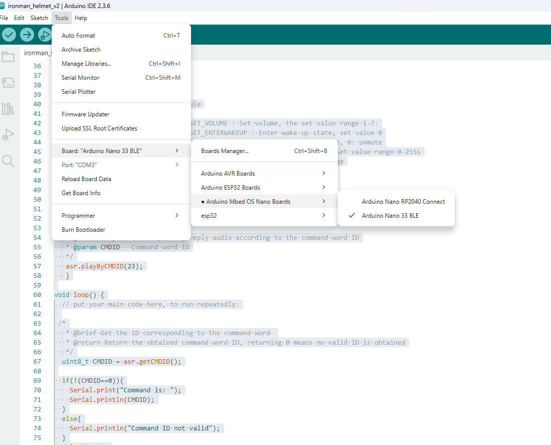

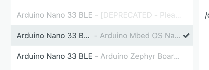

Let's do a sanity check. What board do you have selected. Here is both the old and new views of the correct board selection
If that is correct, why are there so many compiler warnings?
If none of the above yields a fix, I will see if I have that board and try an upload.
I was expecting to be able to select Arduino Nano 33 BLE Rev2, but this is what showed up after using the board manager to install the Mbed OS Nano Boards.
I don't see any Rev 2. I had my compiler warnings set to ALL so don't worry about that for now.
