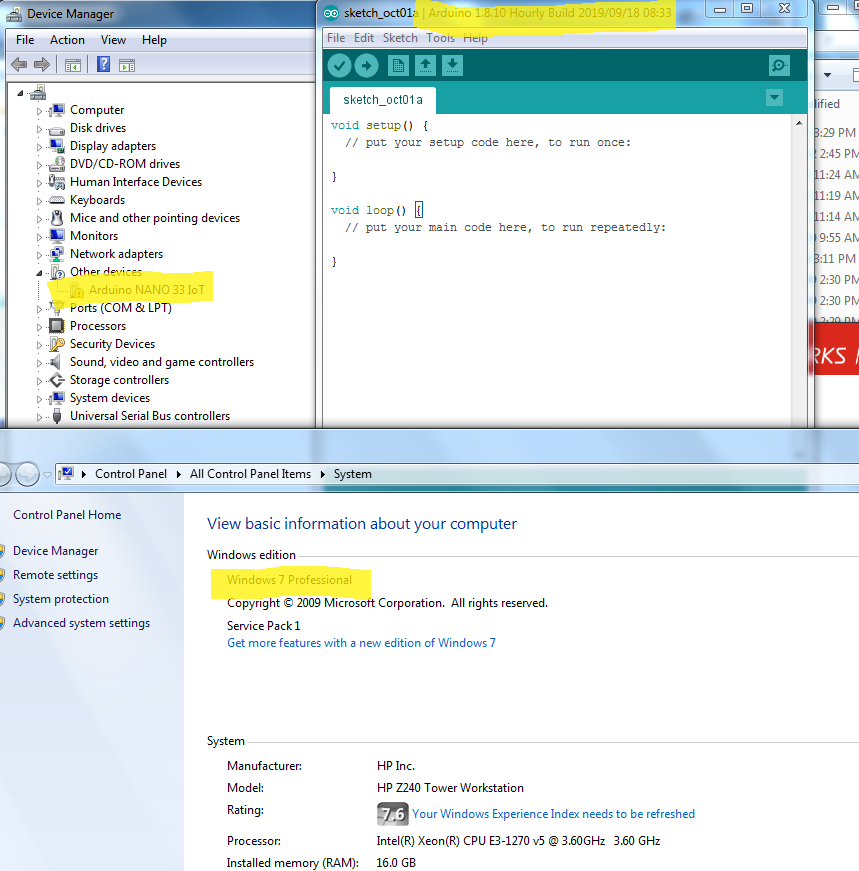

Nano 33 IOT not recognised in Windows 7
Yes, I know this is the typical "connection/driver" issue but I've now tried everything to get the Nano 33 IoT working!
I have a development laptop running Windows 7 64bit. All other Arduino things work perfectly - UNO/MEGA/etc. When I plug any of those in they are correctly identified and the appropriate COM port appears.
Not so with the new NANO 33 IoT. If I plug that into the laptop it appears in the "Other Devices" list as "Arduino Nano 33 IoT".
Prior to plugging the board in to the the laptop I'd downloaded the latest version of the Desktop IDE. I'd also followed the board management instructions for the new NANO 33. All went fine (as far as I'm aware).
Arduino IDE: v1.8.9
Ardiomp SAMD Boards package: v1.8.2
Any help getting this resolved would be greatly appreciated.
//Andy

You seem to have a good selection of computers to play with and that brings me to thinking.
Are these your own personal computers or part of some corporate/educational system ?
If it is the latter then I suspect a security policy or a third party software such as antivirus may be part of the issue.
Also are you installing as ADMINISTRATOR which is also needed on some occasions to bypass user security problems.
Bob.

Bob - yes, corportate prototype work. One Windows 7 laptop has Symantec on, the other Windows 7 laptop does not. It doesn't work on either. Trying Admin privs makes no difference to anything sadly.
Uninstalling drivers, rebooting, re-installing drivers, rebooting - yes, I've been around that cycle many times to no avail.
I've also tried a completely clean install of Windows 7 Pro (again, 64bit). Still no joy. I'm at a loss so can't really continue for the moment.
Whilst I could try using drivers for another board, I'd rather not. This work needs to be reproducible on environments that aren't mine and using a "workaround that may exhibit problems" isn't acceptable. =/
//Andy
If you would both wait acouple hours and clear you browser cache etc before trying again.
Seemingly a fix has been made available.
1.8.3 would be the new fix for boards.
Bob.
Hi Bob,
Thanks for this!
I can confirm that the update works perfectly for the Nano 33 IoT now.

I have run into very similar problems with the Nano 33 BLE.
The automatically installed drivers seem to work fine in Windows 10 and I can upload a sketch no problem.
In Windows 7 the Arduino board shows up in Device Manager under 'Other devices' with a yellow exclamation mark and Device status indicates 'The drivers for this device are not installed. (Code 28)'. No COM port is assigned so I can't attempt to upload a sketch. Double-clicking the reset button doesn't resolve the problem
It seems like there was a fix to the driver for the Nano 33 IoT in a later version of the board software. Is a similar fix going to be required for the Nano 33 BLE board?
I'm running Arduino IDE 1.8.9 and Arduino nRF528x Boards (Mbed OS) by Arduino version 1.1.0.
I have the same issue. I have the latest hourly build.
1.8.10 last updated 16.9.2019
This is really lame the drivers should be working right out of the box.
Hopefully it will work with Windows 10 on the other pc.
I have the latest board version 1.8.3 installed.

Fix for that is to initially turn OFF any additional security / antivirus etc.
Once that is done you should add the ARduino locations to the exclusions / white list of the security.
Also AVOID installing to cloud / network type locations as they may cause these and other types of issues.
Fix for that is to know a little about those types of scenarios and change the system settings accordingly.
As each cloud network can be different there is no "just do this" fix.
If it was a driver issue we would have many many more reports which we do not have so I suggest its an issue local to you at this point.
Bob.
