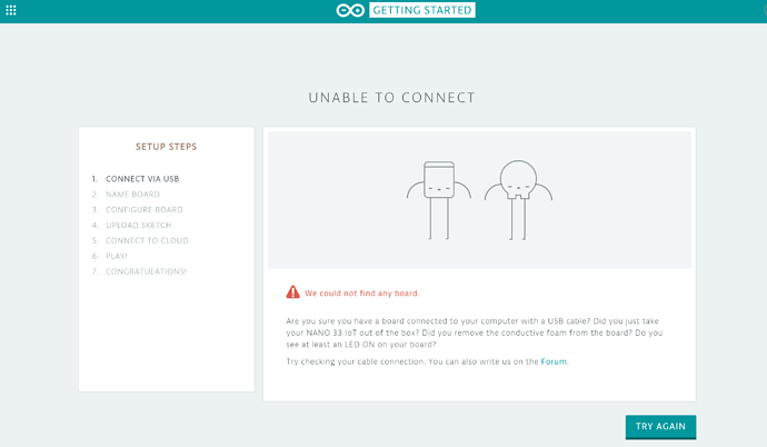

New out of the box NANO 33 IoT is not recognized when setting it up for the Arduino Cloud.
I can upload programs to it using the Arduino IDE without problems.
During the setup, the current step is shown on the left side of the screen. Which step does it fail on?
What is the exact text of the error message you're getting?
Attached is a screen shot of where I am when I get the error.
Thanks. That makes the situation much more clear to me.
When you're using the Nano 33 IoT with the Arduino IDE, in the Tools > Port menu, do you see the text "(Arduino NANO 33 IoT)" after the Nano 33 IoT's port name?
Yes, it says Port: " COM7 (Arduino NANO 33 IoT)"

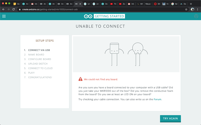

I have the same problem, two brand new boards; Nano 33 IoT BLE-Sense and MKR100, I tried 5 different cables on two computers (Mac and Windows) and different USB ports. Tried both Chrome and Firefox. Uploading a sketch works fine.

I attached the error message that I see in the web interface when connecting the MKR1000. I looked further into the problem with the MKR1000 and it seems that the USB connection is the problem. On both the Windows computer and the Mac there is no available Port to choose after connecting the MKR1000 while using a tested micro USB cable. I tested the cable with the Nano 33 BLE Sense using the Arduino IDE 1.8.12, it works fine. When I connect the MKR1000, the green LED turns on. On both computers I did a fresh install of the IDE, I installed the Arduino SAMD boards and I selected the MKR1000 in the Board menu and installed the required libraries. Double clicking the reset button on the board doesn't help. The board is brand new, I have done nothing with it so far and I did remove the foam.
