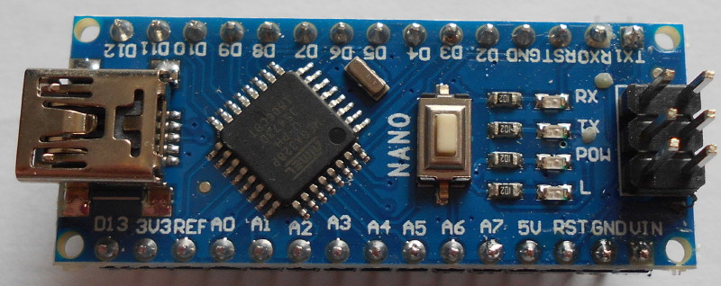

It says nano on the pcb but there is no Arduino logo, layout is "almost" identical to Nano picture on Arduino website, Nano33 looks quite different.
Please post a link to the product that you bought.
Please post sharp focused images of the top and bottom; the text on the chips must be readable as shown below

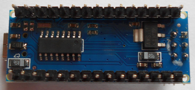

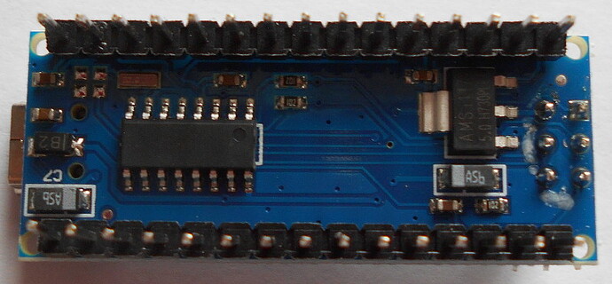

Also images of front and back of pcb Chip is unlabelled so don't know for sure if it is a CH340
And no markings on the chip on the bottom, not even when you take the photo under an angle like I did?
Did you install the driver for the CH340 (chip on the bottom if the board)?
No, I have looked with a magnifying glass at different angles. I haven't installed a driver for CH340, where is that available from?
