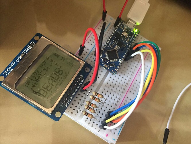

Hi thank you for your response, I'm a beginner in the arduino's world so not sure I get everything. I connected the display to the 5V output of the Every and the pixels finally came alive.
I've been trying to execute the Adafruit_PCD8544 (v 1.1.1) demo code "pcdtest".
It should be looking like that : Adafruit PCD8544 Nokia 5110 LCD library example - YouTube
There is definitely something going on on the screen but it's a total mess. The shapes are uncompleted, there is a lot of noise, the little animation with the falling stars is leaking, I almost never spot any text displayed. And each time I reset it I got a different result...
See the picture attached, on the left what is expected, on the right what I get. Do you have an idea what could cause this ?

Hi
I tried with resistors and still get the same kind of results (see pic attached).
RST > 10k > 3
CE > 10k > 4
DC > 10k > 5
Din > 10k > 6
Clk > 10k > 7
Vcc > 3.3V
BL > None/3.3V/5V
GND > GND
I am using the Adafruit_PCD8544 "pcdtest" demo.
I tried both Registers Emulation ATMEGA328 and 4809.
The animation is still totally corrupted, for some reason I got it running well just once and then it started to mix everything again. Touching the display's pins improved the results once !
Sometimes one or two shapes, texts or animation are perfectly displayed, sometimes nothing show up ... I always have to wait for about 10 sec before the demo starts after each reset.
Also, at some point the TX built-in led starts blinking, what does that means ?
I'm wondering on which side is the issue coming from : Wiring (different results depending if I'm touching/maintaining the wires), breadboard connection discontinuity, Arduino itself (having hard time running this tiny program ?), Buffer clearance management, ..
I uploaded the code from the tutorial I mentioned in the beginning and get the same thing, messed up characters.
No results at all with U8g2 "HelloWorld" demo.
It's starting to be frustrating as I just want to start my project and not be stuck at this point.. I would be interested in seeing a picture of a good wiring, maybe I am still missing something.
Thanks !
Your breadboard looks clean. Your soldering looks respectable. The male-male jumper wires look fairly good.
Chinese male-male jumpers are the usual suspect.
Your wire routeing is obviously ok because the JPEG shows a working screen.
Any instability will be down to broken wires in the jumper cables.
David.
Hi!
So as you suggested I just changed all my jumpers, I also tested them all with a LED and did the same with all my resistors and breadboard holes, just in case. I didn't find any discontinuity even moving and shaking the cables in all directions.
I rewired all the setup as it was yesterday on the picture and today there is nothing showing up on the screen, .. but I'm not surrendering haha
It's probably useless but I'm gonna reinstall the sofware on my computer now.
Is the USB cable a potential source of instability ? I had it from a previous smartphone I had two years ago but is in a very good condition.
Now, is there a way I can test the display itself to spot any undesirable connection ?
A bad USB cable would prevent programming and Serial.
A bad breadboard could be a problem.
Only you can inspect your soldering.
It is very unlikely that the 5110 is a problem. But possible.
There are plenty of examples for 5110 and Uno. This would show if the EVERY has a problem.
David.

Quick update, I tested all the display's pins with a LED, and they are all receiving information from Arduino. the signals vary from one program to another so I can probalby safely exclude the Arduino, the code and the wiring as part of the problem. So now I'm assuming there is an issue with the display, I should probably test with an other one.
Any thoughts ?
Go on. You have just got to remove the Nano-Every and replace with a Nano. It is pin-compatible.
This would determine whether the display is bad or the Every is bad.
A replacement LCD is pretty cheap.
