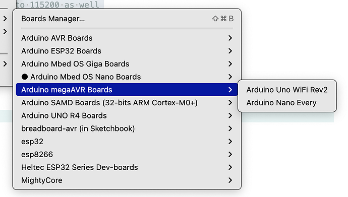

Have your additional boards url's changed? If you look at attached pic you will see that board may not be where you think
I am using the latest 2.3.3 version the on led is constantly on with a moderate blinking of the tx led. I am using Windows 11 and I am sure it is a data cable because my wired mouse with a detachable cable is the cable I am using to connect to the Nano Every.
I was selecting the Nano Every from the megaAVR boards in the IDE.
