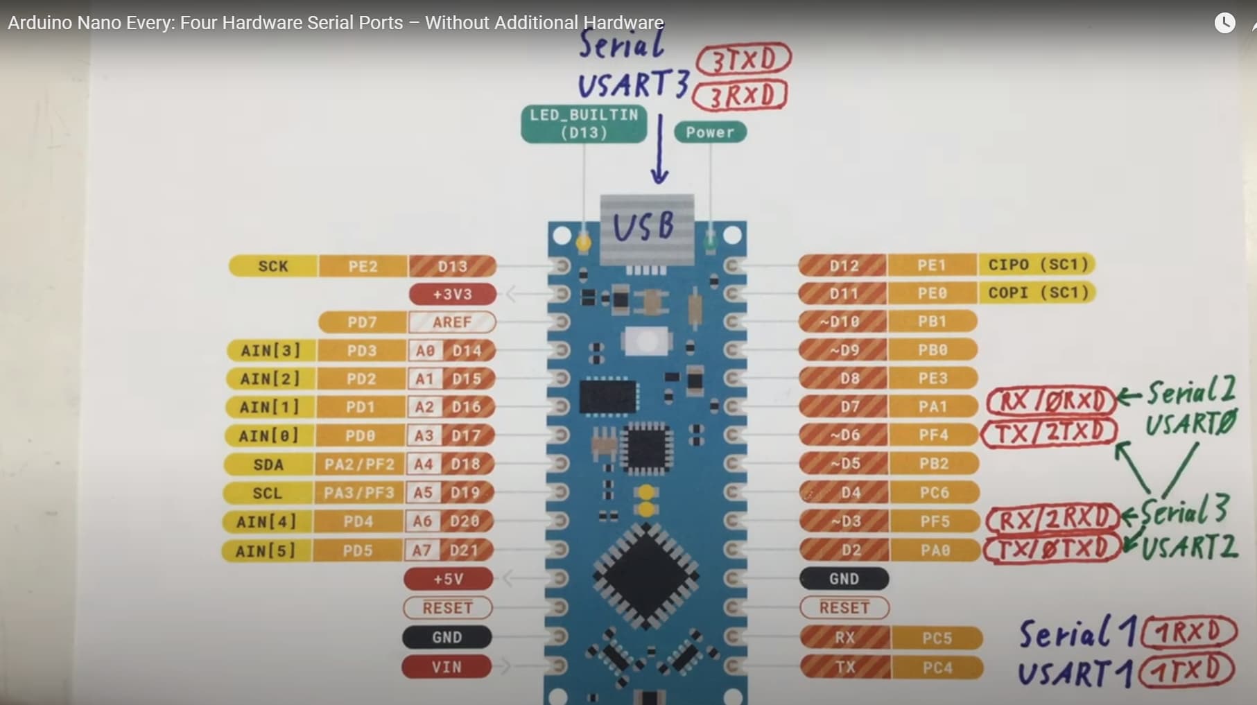

SoftwareSerial at 1000000 baud? I would start by using MCUdude's MegaCoreX which allows you to easily use all four hardware serial ports and get rid of SoftwareSerial. If you have the means to do so, you might want to check the actual baud rate for accuracy, the Nano Every runs off the internal oscillator instead of a crystal/resonator, and despite the box and almost all other literature saying 20MHz, the frequency is actually 16MHz. However, the clock frequency is set every time you program the board, and MegaCoreX has options in the tool menu to select the frequency.
My first guess is that the baud rate is way too high for a software serial port.
I think you can get access to 3 hardware serial ports on the Nano Every but you would need to check this in the documentation.
The compiler does not like the return statement, you have declared the function as returning a byte, but receiveBuffer is a byte*. Not going to matter in this code, because you never use the return value, but might cause unexpected results in the actual code.

nano every contiains an Atmega4809 which has 4 USART channels(
This does mean I need to change my electrical wiring and software. but not sure if the clock frequency is going to be an issue or not.
Will the High baud rate be an issue?
I'll start by implementing the Hardware serial instead of the Software serial in the code.
The pinout from the MegaCoreX github page:
I tried a simple Code and changed arduino_pins.h file ([https://www.youtube.com/watch?v=yG_ialcawho](https://youtube arduino Every 4 channel Serial)) but it didn't seem to work:
Any clue why it wouldn't work?
Edit:
I got this Working, now to try it with the rest of the code starting with sending StarApplication()

   Serial.begin(1000000); // 1Mbps
   while (!Serial);
   Serial1.begin(1000000); // 1Mbps
   Serial2.begin(1000000); // 1Mbps
   Serial3.begin(1000000); // 1Mbps
   while (Serial.available()) Serial1.write(Serial.read());
   // Serial1 TX (TX) --> Serial2 RX (D7)
   while (Serial2.available()) Serial2.write(Serial2.read());
   // Serial2 TX (D2) --> Serial3 RX (D3)
   while (Serial3.available()) Serial3.write(Serial3.read());
   // Serial3 TX (D6) --> Serial1 RX (RX)
   while (Serial1.available()) Serial.write(Serial1.read());
MCUdude's MEgaCoreX can i just extract the Zip into Arduino Files?
No longer needed
The Solution was to Use Serial , Serial1 and Serial2 and to use this to communicate with the to be tested device, the electrical wireing is of importance and i have gotten it to work using the code below as a base:
// Robert's Smorgasbord 2021                                                                                 //
// https://robertssmorgasbord.net                                                                            //
// https://www.youtube.com/channel/UCGtReyiNPrY4RhyjClLifBA                                                  //
// Arduino Nano Every: Four Hardware Serial Ports – Without Additional Hardware https://youtu.be/yG_ialcawho //
   while (!Serial);
   Serial1.begin(1000000); // 1Mbps   Serial1 RX (RX) |Sync module|   Serial1 TX (TX)   |TX module  |
   Serial2.begin(1000000); // 1Mbps   Serial2 RX (D7) |NO module  |  Serial2 TX (D2)    |Sync module|
   Serial3.begin(1000000); // 1Mbps   Serial3 RX (D3) |NO module  |    Serial3 TX (D6)  |NO module  |
