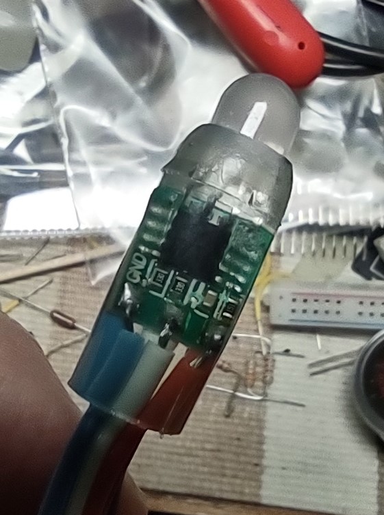

Number of LEDs as indicated in program turn on but nothing else happens; do not turn off or change color.
I have tried different digital ouput pins and no change.
I have tried different LED types and no change.
I have added a resistor to the data line and no change.
I have changed the power wires on the LED and then it does not go on so I am certain the power wires are correct.
I attached a separate power supply to the lights and connected - to Nano ground and no change.

Check the specs for your particular WS2811 strip. I think the 2811 usually requires 12V. (with a "normal" 5V data signal).
12V strips are usually wired with 3 LEDs in series "sharing" the 12V so they are addressed in groups of 3.
You may be able to tell by looking at the strip if the LEDs are grouped in 3's.

These LEDs are 5V and individually addressable.
The ad may have said that, but if they are ws2811, then they are indeed 12v.
Click through your order and post the listing that you purchased.

Do you have a multimeter to check if you really have 5V at the LED strip? You may be getting a voltage drop. You can also use a multimeter to check the other connections.
USB can't provide enough current for 50 LEDs, although it might be OK depending on how many LEDs & colors are on at a time.
You can figure 20mA per-led, per-color, so worst case 60mA per RGB LED or 3 Amps for 50 LEDs. It's "good practice" to design for worst case even if you don't intend to run all LEDs at full-brightness white, but you can "fudge" a bit.
USB is good for about 1 Amp and you shouldn't run more than about 1A through a breadboard.
I think the 5V power also goes-through a chip on the Nano board, and that's probably limiting the current even more.
It's possible that the LED strip is simply defective. The data is serial so if the 1st chip/LED is bad it can kill the whole strip.

There's a socket on one end and a plug (pins in) at the other.
On mine, the data goes in the socket.
Do the circuit boards with yours have the big arrow like mine?
No, I have some of these and they are 5V.
Many WS2811 strips are 12V and these have groups of 3 RGB LEDs to one WS2811 chip and are not individually controllable.
But these LED "strings" have 1 WS2811 chip per RGB LED and are 5V.
You may have damaged the first LED in the string. Consider doing a return/exchange. Use a quality 5V >3A power supply. Hot to red, Ground to white and to Arduino ground, and green to Arduino data pin.
Use FastLED set up for ws2811, 50 leds
Maybe the data was in the wrong end.
12V probably didn't help.
