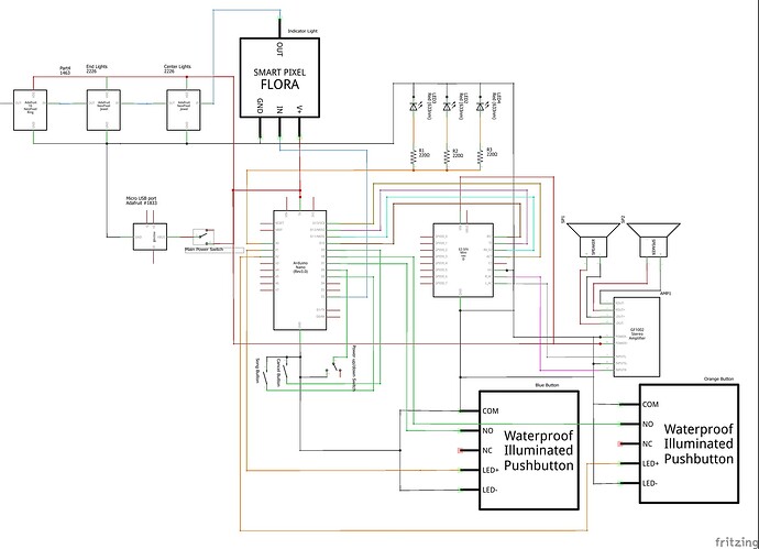

I am following this schematic,

I see 3 LEDs with 220Ω resistors (40mA total) connected to pin A0,
button LEDs with no current limit resistors connected to A1 and A2. How much current do those LEDs draw?.
Use the DMM on voltage scale to probe the board. With the USB connected, first check the 5V and then the 3.3V pins.
I assume you know that the ground lead must be connected to board ground for those tests.
That isn't the whole thing, but it's where to start.
I have actually switched out those LEDS for non LEDS one for A1 and A2, so the code for those pins have also been disabled.

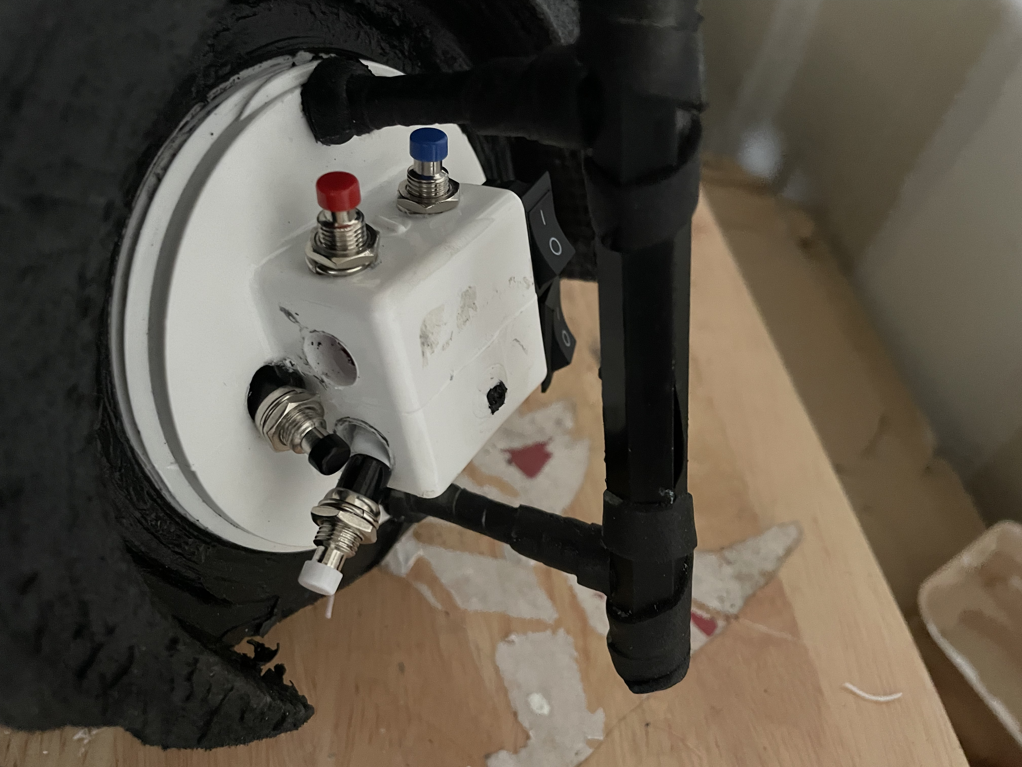

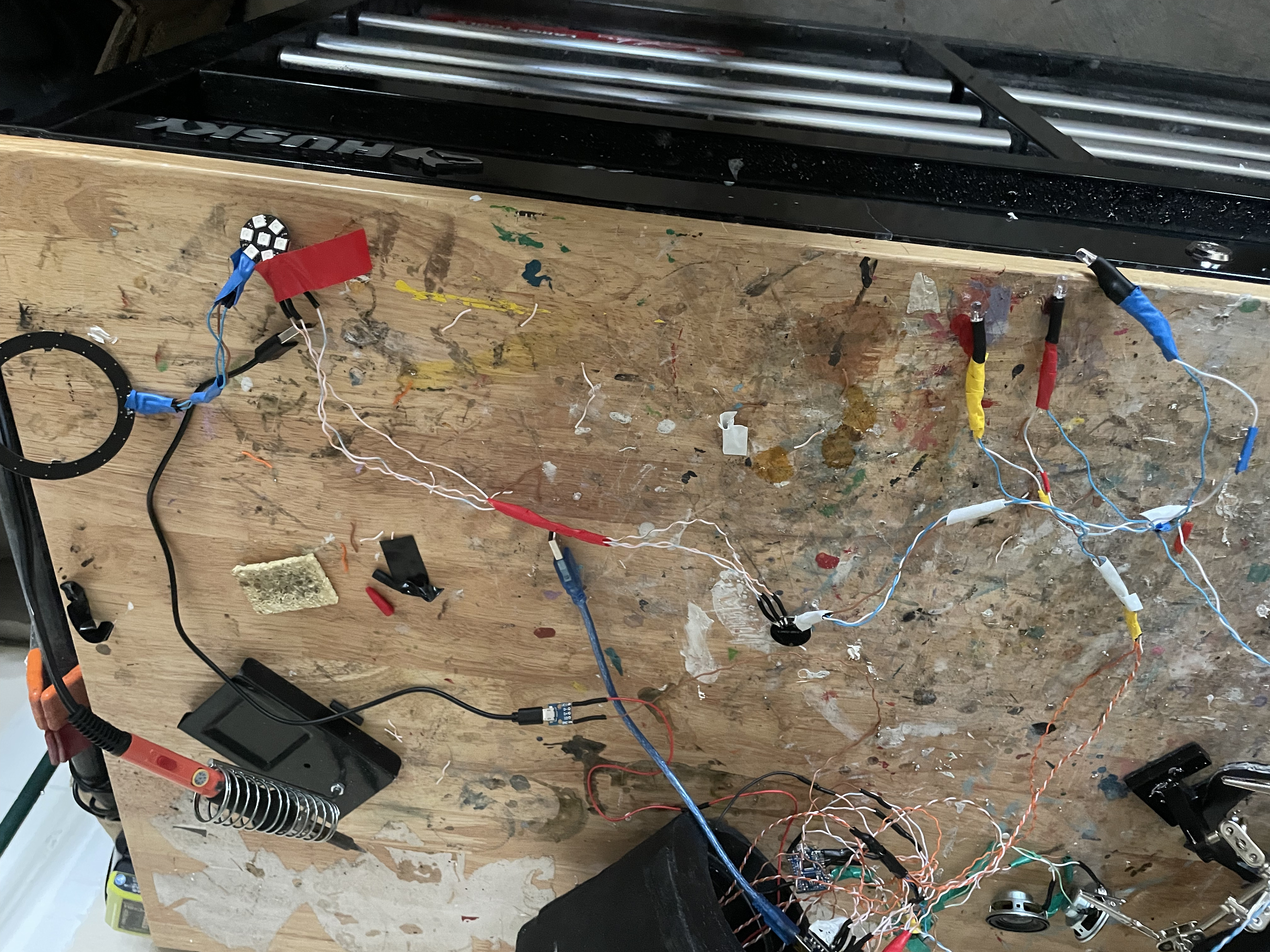

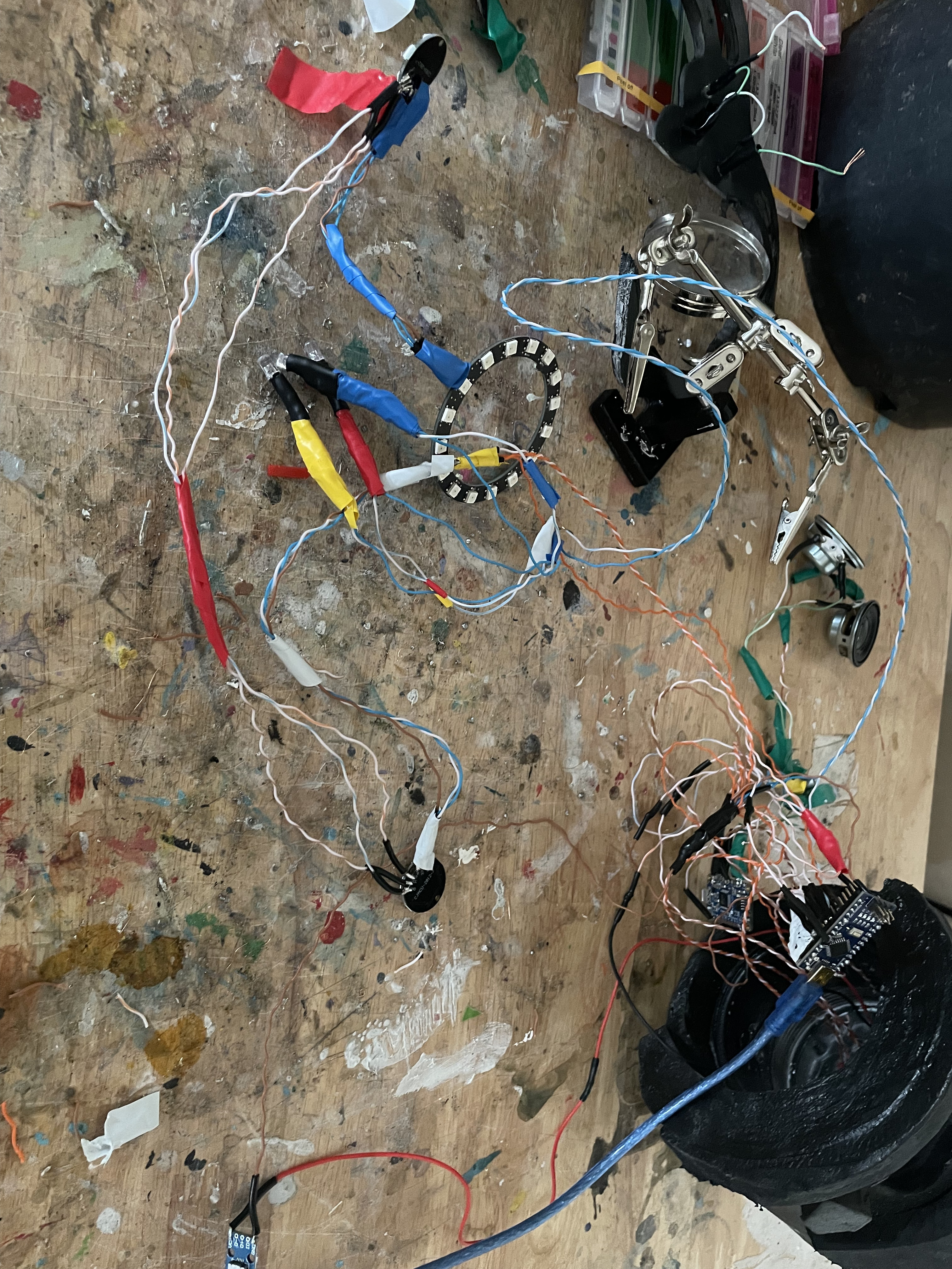

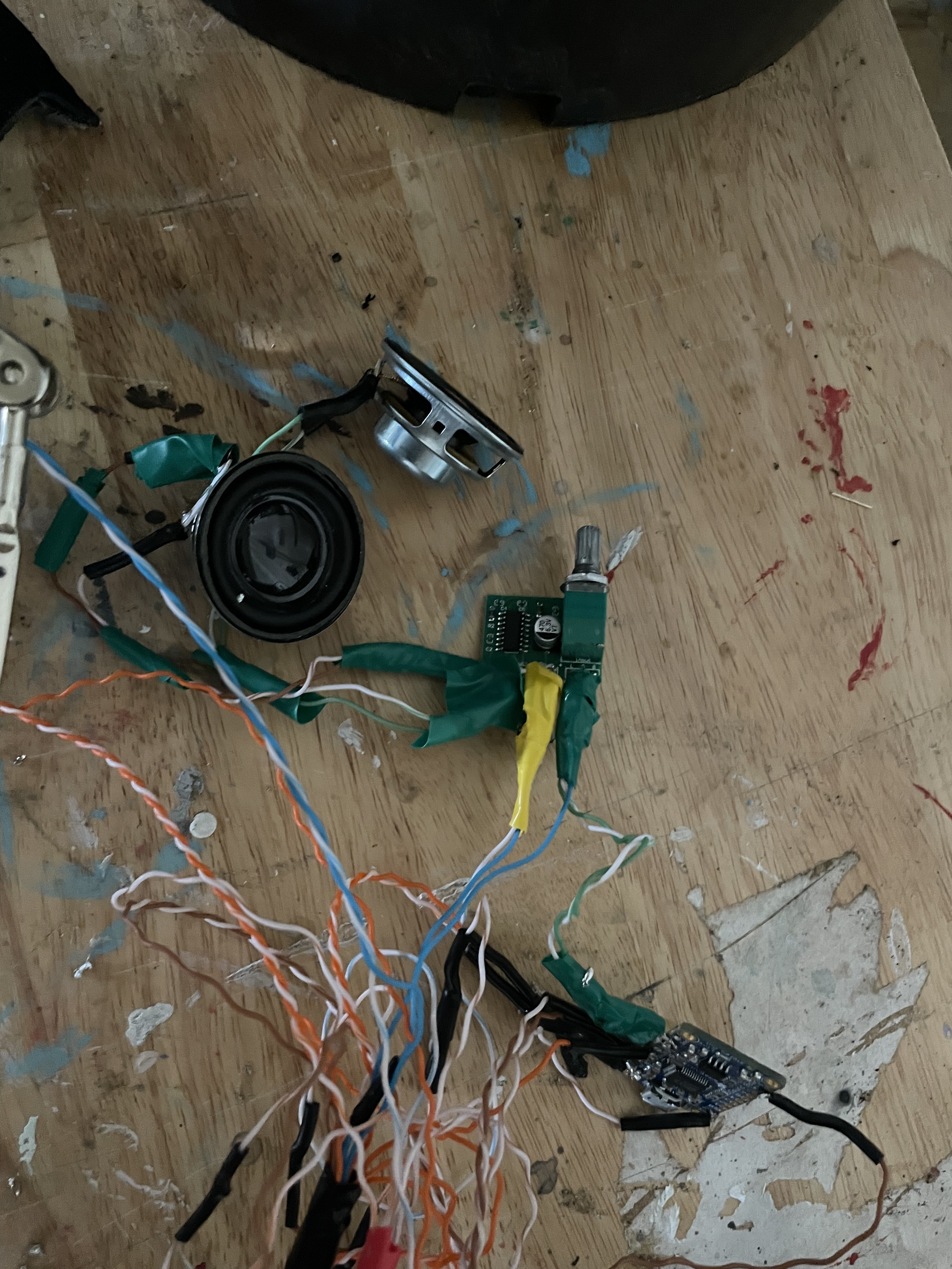

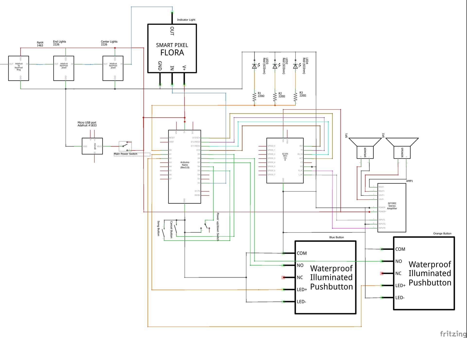

My work isn't pretty, but here it was before I removed the arduino. Everything follows the diagram above in the main question (except the usage of A1 and A2 since those are disabled) .
Whole Project
Buttons (loose right now, haven't secured them down)
Lights
Audio

According to the diagram I was using, it was used as an input for the power from the USB. The power in the diagram was wired to the 5V from the switch which the switch was connected to the USB. So I am likely misunderstanding what you are saying, but if I am understanding, it was wired that way.
