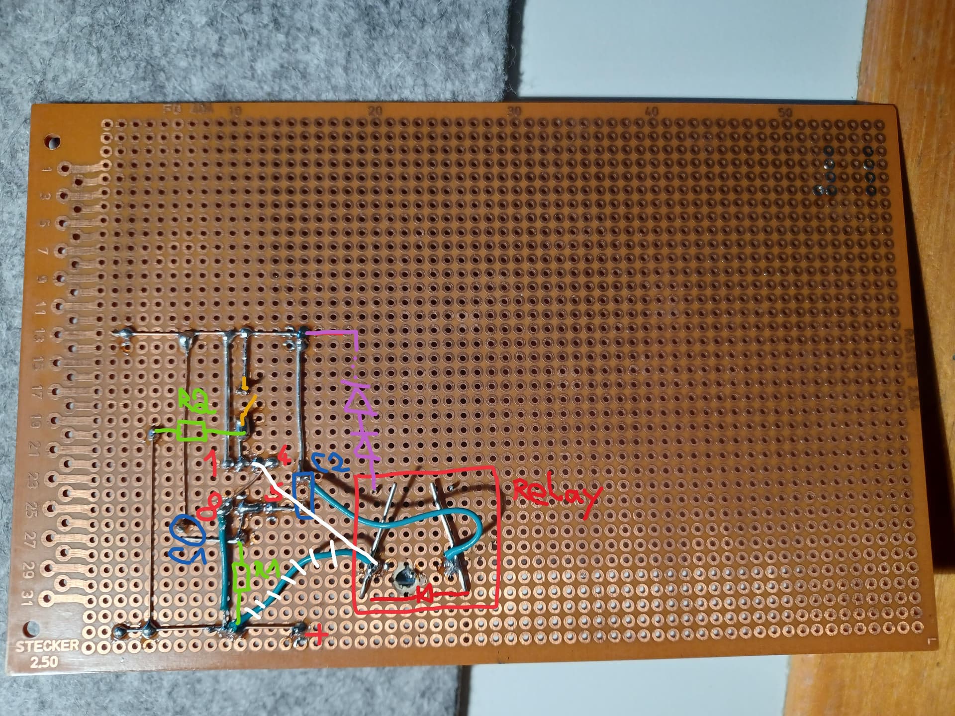

I have an NE555 monostable circuit. I want to drive a 1.5W LED Strip, for that I have a 5V relay. The circuit works fine until I connect the relay to the output of the NE555. If I do that, the relay turns on on my button press, but not off anymore. I measured the voltage over the capacitor and it only rises until about 2/3 Vcc. It then fluctuates around that voltage.

This is my actual wiring with the components on the top drawn in. The white line is where the relay is supposed to go, the crossed out one was to test whether it was the voltage drop causing the problem.

Show us a good image of your ‘actual’ wiring.
When the relay is energized, measure the 5v supply ?

The supply drops down to about 4.9V. It all works fine tho if the relay is connected to plus directly instead of the NE's output. Then the voltage drop doesn't cause any issues. It is really just when it is connected to the output pin
Yeah, I will do that tomorrow and then test each component on it's own.
