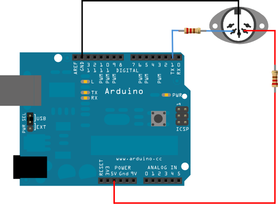

   Serial1.println(val);
Note it also prints messages out of the Serial1 pins, to see them open the Serial1 monitor window.

OK try replacing the
with
Serial.println(val);
Then just open the serial monitor from the sketch window.
