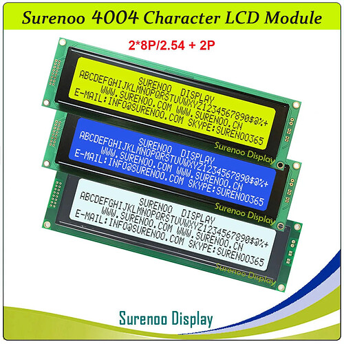

Need Code for ESP32 to 4004 Character LCD Module with I2C Interface
Does anyone have code for an ESP32 to write to and control a 4004 Character LCD module with an I2C interface?
The part number of the display with the plug in I2C interface is 4004A2-BLW-IIC made by Sureno from AliExpress.
I checked with Surenoo and they only have code for the Arduino.
The ESP32 board I'm using is a SparkFun IoT RedBoard - ESP32 Development Board

The I2c board comes with the display. I have not tried it out yet. The company has only provided me with Arduino code which I have posted. I need to use an ESP32 instead
Here is a link to the companies website where I purchased the board.
display with i2c board

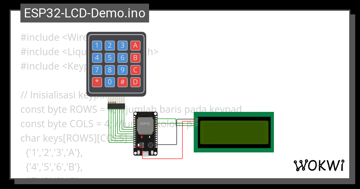

I2C is I2C .
And the PCF8574 is the most common used chip for these adapters
Here is a WOKWI-Simulation that uses an ESP32 and a 20x4 Display.
This display works with the standard-"Arduino"-libraries.
The advantage of this modular-concept of libraries is that
higher-protocol-levels of any kind can be used with different microcontrollers.
If you lookup the library-files where the lib-files are stored and there is no special version for your microcontroller then it will work with your microcontroller.
example for a special library that is stored in the hardware-package
....packages\arduino\ hardware\esp32 \2.0.17\tools\sdk\esp32s3\include\esp_wifi\include\esp_wifi.h

The manufacturers website
says
SLC4004B is 40 characters wide, 4 rows character lcd module, AIP31066 controller (Industry-standard HD44780 compatible controller), 6800 4/8-bit parallel interface,
controller is HD44780-compatibel

The HD44780 chip set only supports 80 characters. To get 40X4 they treat it as 2 40x2 in one package. The code has to handle the display as 2 different parts. To free up a pin on the I2C interface they tied the R/-W pin low so it is in write only mode. This frees up a pin to use as a second enable.
