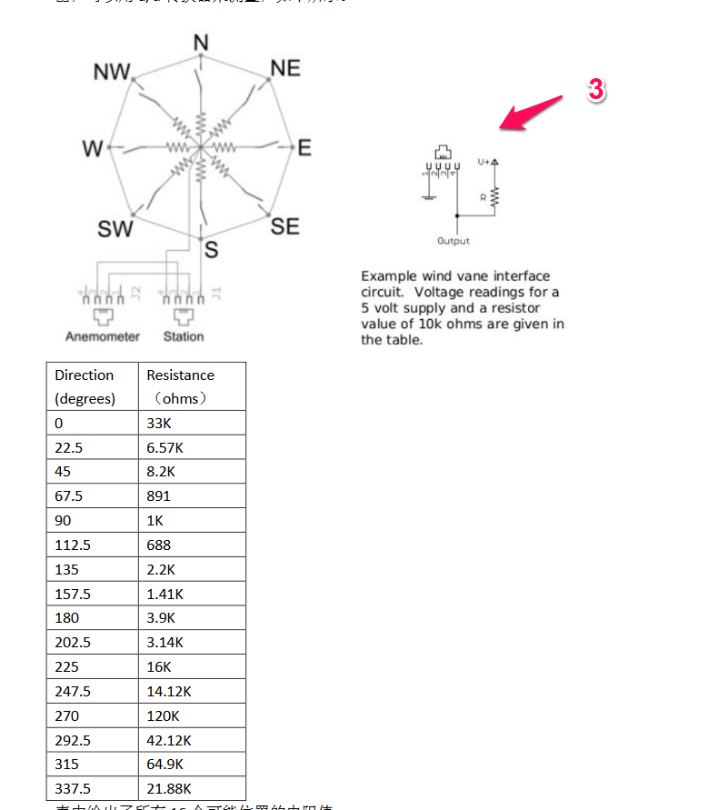

Need guidance on wiring the sparkfun weather meter kit
Hi there!
I finally found some time to start dabble with a esp32 i had on the shelf for
a while.
I have have been programming for years as a hobby and i have been curious about
embedded systems , now finally i got time.
So filled with ambition i ordered the sparkfun meter kit, rj11 plugs, etc
and started wiring this up. This is where my trouble starts.
I can get the anemometer working standalone, same with the rain gauge.
but when i connect the anemometer up with the wind vane, i dont get any readings.
Im guessing im wiring this up wrong and the diagrams on their site are to a beginner like me
worth close to nothing.
So what im asking for realy is some help with the wiring.
If there is anny information that is lacking in this cry for help please let me know and i will try to answer as good as i can

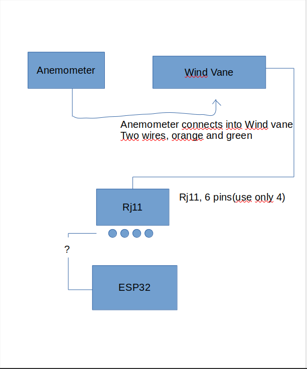

So to make make it a bit clearer for people to understand what the problem is will add a list of items in use and a image that discribes the problem( I hope )
so the issue:
The anemometer and wind vane is connected together.
The anemometer connects to the wind vane via rj11, then the wind vane connects to
a rj11 socket. The rj11 socket needs to be wired to the esp32, This is where i come in trouble.
how do i wire this correctly to get independent reads from both peripherals

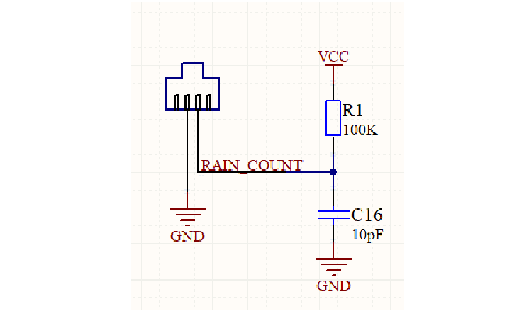

  1. Connect the two innermost pins of the cable from the rain collector one to ground, the other to the rc circuit shown ( VCC = 3.3V ), connect the rain_count to pin 27 of esp ( so to match the basic example of sparkfun library )
  1. Connect the two innermost pins of the cable from the wind sensor one to ground, the other to the rc circuit shown ( VCC = 3.3V ), the connections of the R/C is the wind_speed signal connect to pin 14 of esp

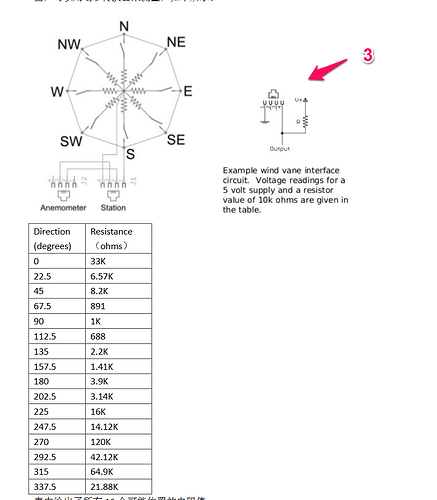

  2. Connect the two outermost pins of the cable from the wind sensor one to ground, the other to the r circuit shown ( V+ = 3.3V ), connect the output to pin 35 of esp ( hope the sparkfun library consider a R = 10K )

Hi

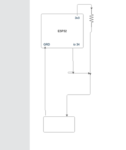

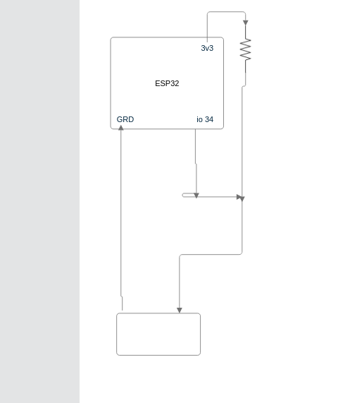

I have now tried to follow your guide. this is what i got so far.
The result is kinda dodgey(probably becouse i do it wrong) but now i get a response on the voltage when i move the anemometer :slight_smile:

As you can see in the table linked above, as you move the 'wind direction' resistance will bounce back and forth, so your analog reading.
Nope. Im using Micropython for this project. handling the code should not be a problem, its the wiring i struggle with :slight_smile:

ok. The you can use the below table to calculate wind direction

Can you read the Analog input and print it to a monitor screen?
I think you have more problems than just the wiring. Have you read the analog input requirements? Look here

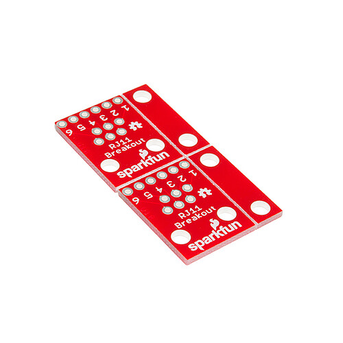

Ok, I spotted a problem. The breakout boards you linked to are for RJ45 sockets (8-pins), but your sockets are RJ11 (6-pins). So I doubt they will fit the sockets, and even if they do, this will confuse the wiring problems even further.
You need the RJ11 breakouts like these:
The next source of confusion may be that the RJ11 sockets have 6 pins but only 4 are used. But which 4? The images provided by Sparkfun are not helpful here because they show only 4 pins:
WindVane_Switches
I have used these sensors before. Use your multimeter on resistance measurement range and try every possible pair of pins, while slowly rotating the anemometer and vane, to see how the resistance readings change. For most pairs, you will get no reading ("E" or "-" or something).
When you find the correct pair for the anemometer, you will see alternating readings of zero (or close to zero) and no reading ("E") as the anemometer rotates, 4 changes per rotation.
When you find the correct pair for the vane, you will get 16 different readings as the vane direction changes.
Tnx for your answer it helps alot :slight_smile:
I got these breakouts for rj11
image of rj11 breakout
