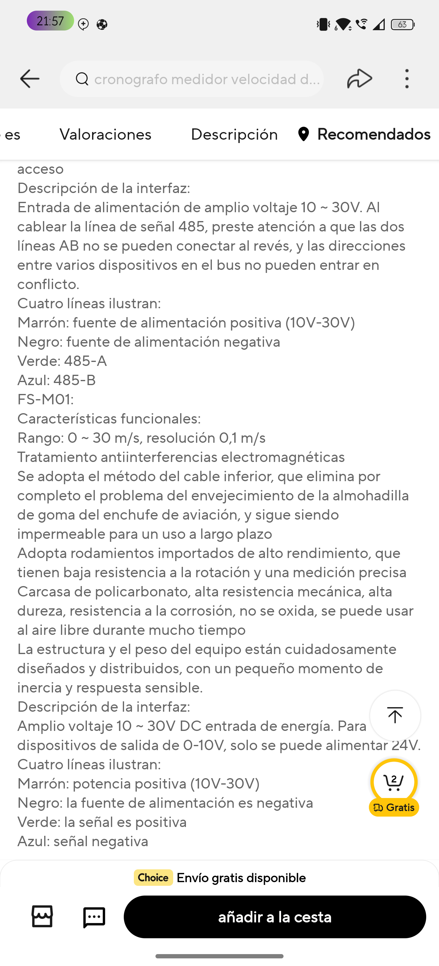

Hello, I'm trying to use a ZTS-3000-FSJT-N01 anemometer which uses RS485 protocol. I've connected the black and brown cables to a 15V power supply that's working fine. The yellow cable to the A+ and the blue to the B- of a RS485-TTL converter. The GND cable to the GND on the ESP; the RXD to pin 22; the TXD to pin 21; the VCC to pin 3v3.
I'm using esphome but I'm completely unable to make esp32 read the values. Mind to hand me any help?

It's this one
https://a.aliexpress.com/_EHXlZJV
The converter
https://a.aliexpress.com/_Evg6yCj
The board:
https://a.aliexpress.com/_EHjYaXv

Ok, it's modbus like expected, but we need some protocol info. At least register addresses (and baud rate and slave address). Any idea..?
You could go "fishing" the data, but it's not beginner task for pleasure :slight_smile:

Looks like your device should be at address 1, either 4800 or 9600 baud..
You should be reading register 1..
Is your 485 adapter compatible with your esp32, 3.3v??
