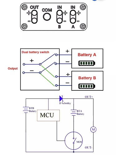

I just obtained this schematic from the vendor I bought my diode from. It appears it's a bit more complex than just a Schottky
It appears that the contraption I have might be all I need to safely run the packs together?
Any other fail-safes necessary?
Then you are strongly advised to stick to hardware, such as the battery switch, that is designed for the job.
Ebike battery fires can be very serious.

Why worry about diodes when a BMS would do? Maintaining a balanced charge on each individual battery is what a BMS is designed to do.
It's 14s, they both have their own common port BMS built-in. The BMS don't support parallelling natively but they do have a diode to prevent reverse flow through the discharge ports.

The contraption I posted a schematic of seems to bring them into perfect balance after about a half hour
