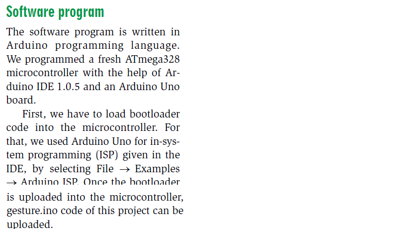

Hi I use Atmega 328 Microcontroller for my project. It needs that code has to be uploaded into the MC using Arduino board. I had placed the MC on the uno board and tried to upload the source code. I got error saying unable to program the board.
I am attaching the details of what has to be done.. The project was gesture controlled robot given in electronicsforyou magazine Jan 2015 issue..
This link provides the details: https://www.arduino.cc/en/Tutorial/ArduinoToBreadboard

Haa checked with the link and couldnt get anything from there. I think its the bootloader problem. How to upload the bootloader which is in examples--> arduino-->ArduinoISP.
What should i select in the programmer file menu option.
Do you have another arduino board or, can you order a usbtiny like something ?
