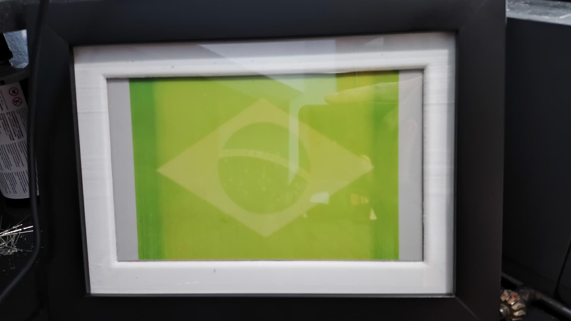

I bought a 7.3in 7 color display, and I was able to make it work with the waveshare demo code and with gxepd2 examples from @ZinggJM. But the reason why I bought this display was to make a digital portrait frame, so I found a nice repository from github user dani3lwinter that had exaclty what I needed. After hours adapting the code, I hit a dead end. The code works flawlessly with small images, but when I upload full resolution images (800x480) the colors are not displayed correctly and with some noise. I made a fork with my code and the issues is either on the html functions that pre-process the image or loadImage function that receives the data on display.h. can someone help me find the issue?

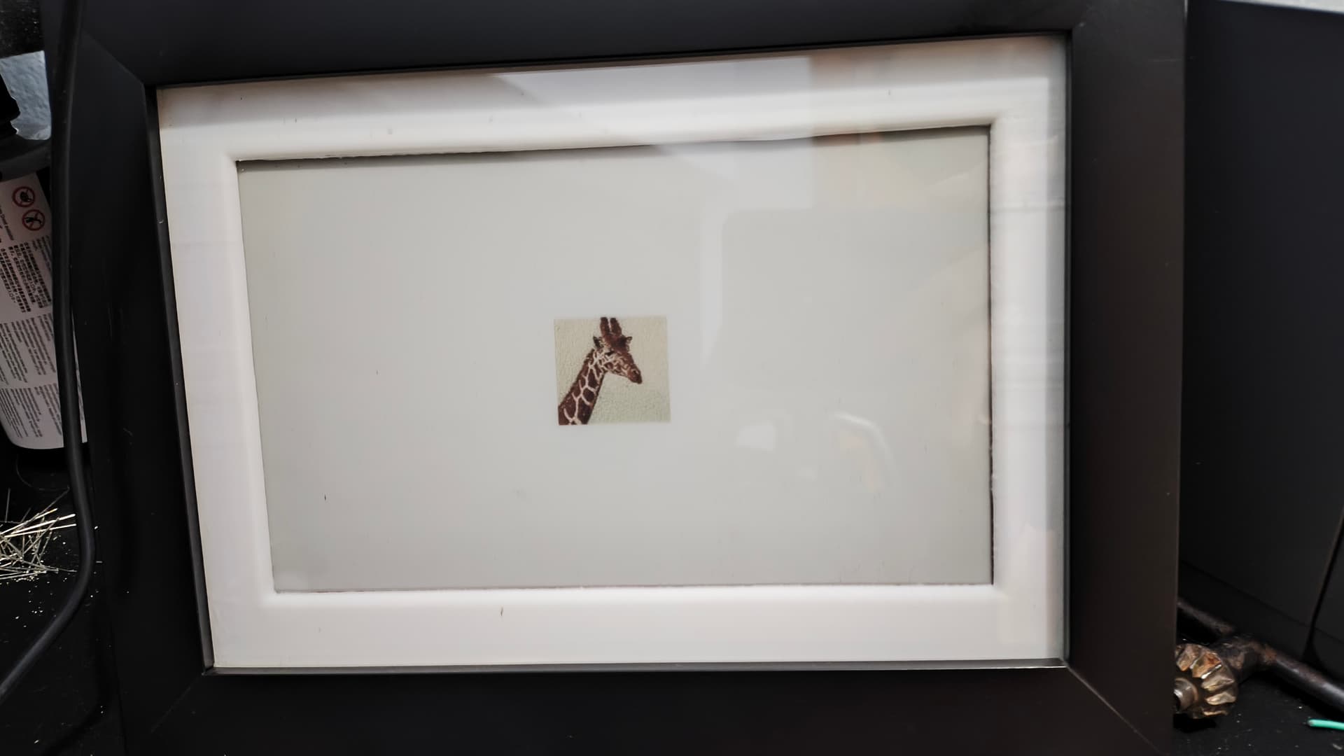

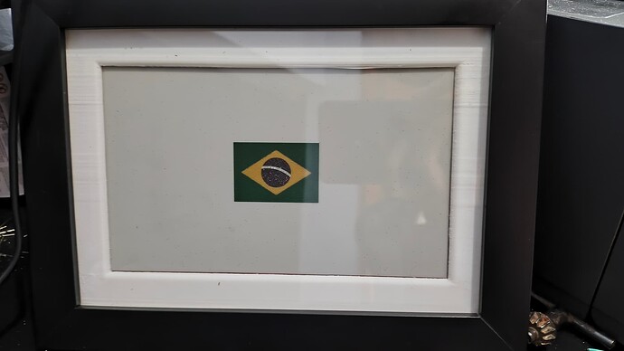

After the post, I began testing some different resolutions. Here's what I found: below 200x200 colors are fine, between that and 400x400 image is black and white, and above 400x400 it appears yellowish as pictures above. I don't know why and I will check on this later, my head is boiling. Hopefully someone will figure this out
I think the problem is dithering, it's done by the code that's in the html file.

Thanks, @MaximoEsfuerzo I'm also starting to think the issue may be on the html because of the test I mentioned above. The original code that I forked used a 3 color screen (black, white, red) with 640x384 resolution, so maybe this is why some images appear only black/white on some resolutions and with incorrect colors above that. I still need to figure out why 200x200 images and below worked tho
