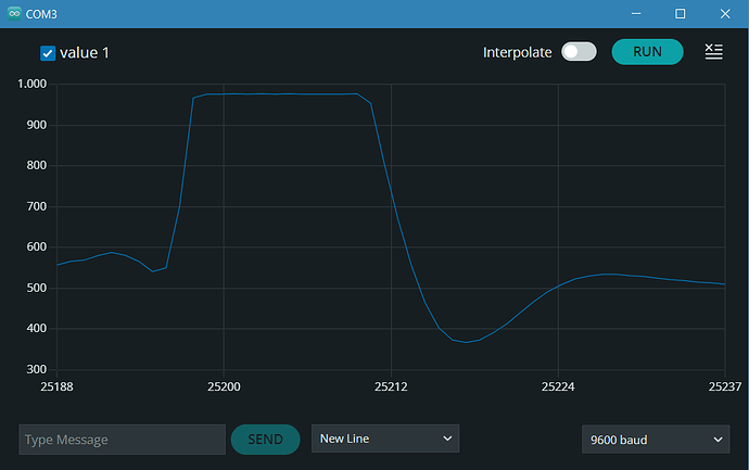

Hi everyone. I just got a pulse sensor and the thing is being a headache. It just gives me the same kind of reading no matter if my finger is on the LED or not, just some random numbers in the 500's (mostly between 508 - 520, but sometimes goes to 550's) I know the sensor is doing something because the numbers greatly change when I'm in the process of moving my finger (putting on or taking off), but a second later it's back to the 500's.
To illustrate, this is a print of my plotter when my finger is on:
and this is when it's off:
and this is the exact second I took my finger off:

Most likely, you have a defective sensor or a wiring problem. Please post a close up, focused photo of your setup.

Yeah, I'm considering that it might be broken. It's wired just this:
"-" on GND, "+" on 5V, "S" on A0. The only difference from the site is that my wire doesn't have the jumper-like pin at the end. Could this cause the problem? I never used wires like this, but that's how they came so it's supposed to work.

The bare wires shown in the photo are not making reliable connections. You need to use connectors with square pins.
You could try folding the bare wire back on itself, so it makes a tighter connection in the header socket.
Or, if you have jumper wires with square pins, cut a jumper wire in half, strip the insulation off the free end, and twist the wires together tightly (for each of the three sensor wires).

Added the square pins from some jumpers like you recommend. There's more difference between fingers on/off now and the graph is slightly better with more defined peaks, but the problem remains. Only a very small variation in the early 500's, nothing that looks much like a heartbeat :melting_face:
My guess is that you have a defective sensor.
