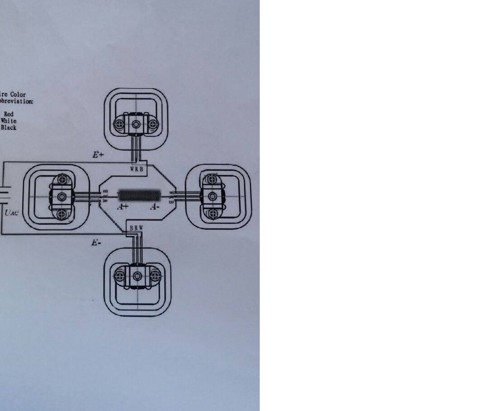

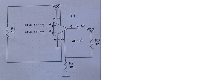

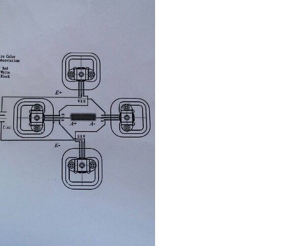

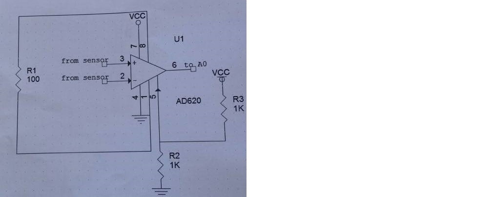

hi i working on scale with half bridge and i got a problem with the code so if you can help me to know the code of my program i will be very thankful i tried alot of codes but i dont find the solution of that and i know that i connected the right wires and resistors and everything there right beacuse i found it works on friend working
i send to you guys the files that show my connections
i useing arduino uno and keypad 4x4 and lcd 16x2 that what the university want from me.
thanks :slight_smile:

I don't see a diagram and/or a picture of YOUR setup either.
A half-bridge has ONE 3-wire load cell and two fixed resistors.
I see four load cells on that picture.
So what DO you have.
Be prepaired to be disappointed with the resolution of an AD620/Arduino combination.
It will be ~200 A/D values at best.
A HX711 breakout board would be much better for this.
Leo..
