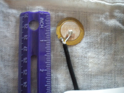

Richard: the sensors I use are pretty bare. They must be more sensitive than the ones enclosed in plastic. Here is a picture of the "wire side" of one of my sensors:
I usually have a piece of Velcro stuck to this side and this goes against my skin. I find that this makes it easier to activate the switch. I think it provides more leverage to bend the sensor.
Here is a picture of the other side:
This side is just flat copper and my caregiver puts a piece of paper tape over this side and tight across my skin.

Sammy: as you can see, my sensors are pretty big. I have used smaller ones in the past, but these are easier and last longer. I have seen the $1 ones you mentioned, but haven't tried them yet.

The piezo you showed us looks pretty generic, except that (nearly??) all the ones I have are made with a hole in the brass disk so that almost all the piezo part is exposed. Probably because they were made for use as speakers. The solid brass disk might be necessary to keep sweat and oils from getting on the piezo disk. Or it may be coincidental. You should find out before buying more.

an hour ago i've tested my cheap and standard 2.9kHz piezo (which has the same size and looks a lot like yours on the images you posted) with my belt pressing it above my eyebrow. ... kind of Karate Kid :wink:
I used Processing with the sketch from the following tutorial to visualize my eyebrow movement as a first step: http://arduino.cc/en/Tutorial/Graph
The sensitivity was very good! Also slight movements has been triggered.
Hope this helps. Sammy.

It occurs to me that you need to be sure it actually is a piezo. normal
electrical medical probes can look similar, as can capacitive pickups.
