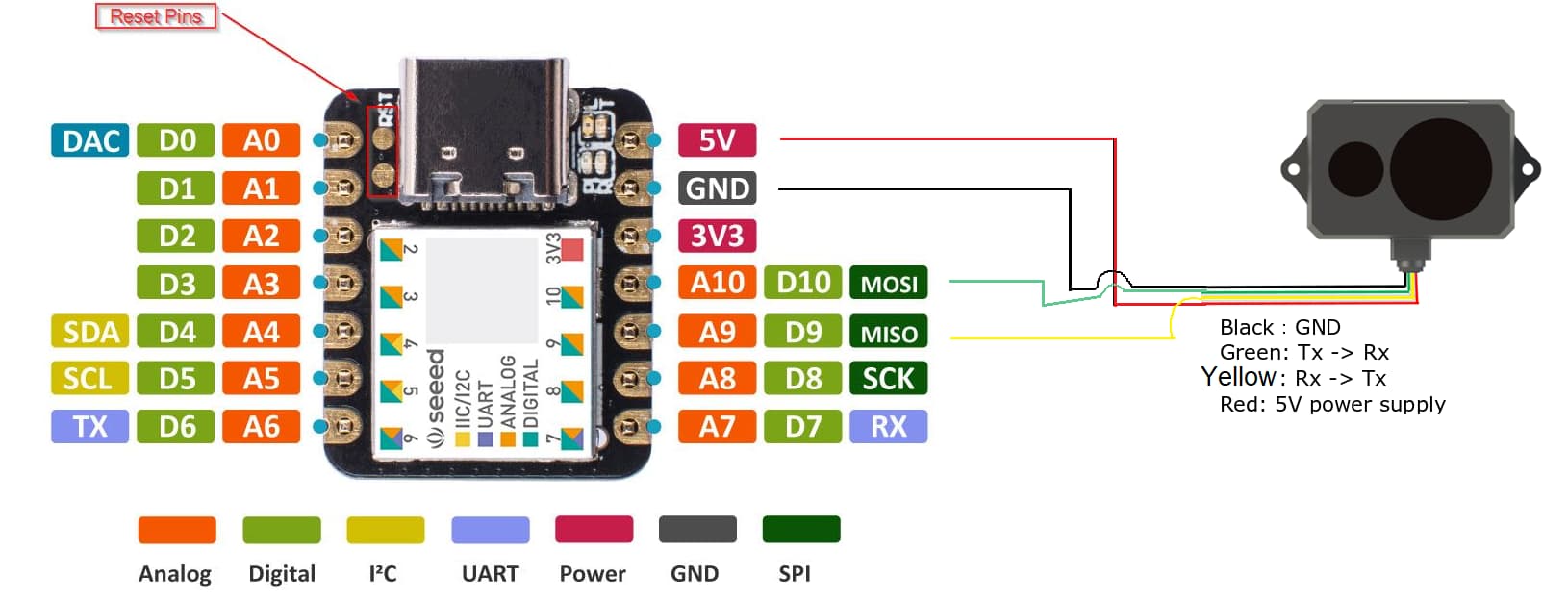

Hi all,
I have a Seeeduino XIAO. It speaks 3.3V TTL, as does the TF-Luna, so no TTL coverter is required, which is nice.
I have installed Bud Reyerson's TFMini Plus library, and am attempting to run his example code. I am using UART communications, with software serial on ports 9 and 10.
Here is my code. It is exactly the example, except I put in my pins 9 and 10.

Here is my device:
Here is the pinout of the Seeeduino XIAO:
Here is the pinout of the TF-Luna:
When I run the code, this is the output:

I tried switching pins 9 and 10 in the code and then I get:
20:38:19.311 -> Status: HEADER
20:38:19.311 -> Data: 00 00 00 00 00 00 00 00 00
20:38:20.388 -> Status: HEADER
20:38:20.388 -> Data: 00 00 00 00 00 00 00 00 00
20:38:21.412 -> Status: HEADER
20:38:21.412 -> Data: 00 00 00 00 00 00 00 00 00
20:38:22.479 -> Status: HEADER
20:38:22.479 -> Data: 00 00 00 00 00 00 00 00 00
Can anyone help me talk to the TF-Luna?
Thanks.
From the dangling, unconnected wires (which, incidentally, is never a good idea!) it appears that you did not apply 3.3V to the configuration input on pin 5, as required to enable UART output.
Are you intending to use I2C or UART for data? Please post a hand drawn wiring diagram, showing which pins are connected, with labels.
Here is what I have wired up right now. The device has blue wires for the TX and RX lines. I have used Green and Yellow in the schematic.
I have been looking at YouTube videos and they left the last 2 pins hanging free so I assumed they were not necessary. But I see what you mean - it looks like Pin 5 needs to be 3.3V to communicate UART. I will try that.
Also, I notice that the Seeeduino seems to have provisions for UART RX and TX on pins D7 and D6. Should I be using those? Is there a different way to call them?
So, you have not applied 3.3V to the configuration pin, and therefore, cannot expect to be using UART communications.
Consult the Seeeduino documentation to see if there are restrictions on using pins with Software Serial. Which, incidentally, does not work at 115200 Baud (at least not on AVR based Arduinos).
I have connected Pin 5 to the 3V3 pin on the Seeeduino with no change in the output.

I've now got pin 2 (RX) from the TF-Luna going to TX (D6) on the Seeeduino, and pin 3 (TX) from the TF-Luna going to RX (D7) on the Seeeduino. This yields:

OK I got it to work. BTW, the TF-Luna defaults to serial, so there is no need to connect pin 5 to 3.3V.
Here is my current schematic:
I did not have any luck with the printf.h calls, so I deleted them and replaced with Serial.print and Serial.println to get the output to the Serial Monitor.
My problem was that I had the RX and TX pins reversed. This particular TF-Luna I bought came with all the wires BLUE except power and ground (red and black) so it is easy to make a mistake - you have to follow each wire back to the unit and make sure you have the correct pin.
This is quite a powerful little microprocessor. It has an independent Serial port (pins 6/7) which are independent from the USB. Also supports I2C (I have no idea how to use that though). It speaks 3.3V TTL which is what the TF-Luna supports natively so no need for a TTL converter. And it's tiny. And it runs on 5V as does the TF-Luna.
For anyone who stumbles on this, here was my prototype code that works:
