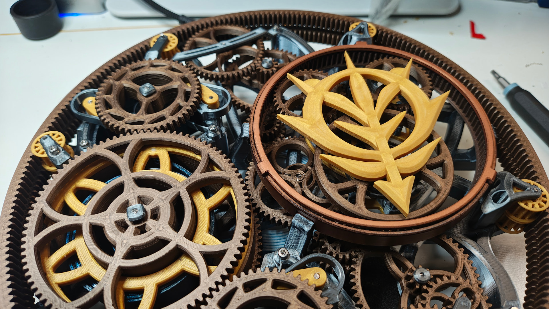

I’m currently building a 3d printed mechanical clock and i need to power it from a motor instead of the PETG spring. It’s working perfectly, but the spring goes on only for 8 minutes…
This clock will be placed under a circular rotating glass and it’s not needed to be accurate as a clock itself, but only to move the gears and the tourbillon.
I have a pair of 24BYJ that maybe wil be enough to power the clock. I know that they can be modded to bipolar and in that way they have more torque.
The tourbillon limits the movement of the gears, so an arduino is required to add a pause between movements to avoid too much force on the gears teeth.
The motor needs to rotate at 3 rpm minimum if I use a 9 teeth gear on the tourbillon directly, at 7 rpm if I use the central gear and at 11 rpm if I use the barrel gear.
There is not so much space to place the motors, so if the one i want to use is not enough i need something small.
The material used for the clock is PLA, and it soften at around 50C so the motor and the driver needs to stay cool enough. Eventually i can put a metal plate on the bottom (it’s 20 cm of diameter) to help dissipate the heat. Because it will powered by a battery i don’t want to add a fan or to be power hungry.
The battery is a 12.000 mAh PD Powerbank connected with a USB-C selector to provide 5V, 9V or 12V. The MCU will be an Arduino Nano.

How do you intend to fasten the steel shaft of the motor to a PLA gear?
Can you be more specific please.
It’s this AZDelivery 3 x AZ-NanoV3-Board Mini USB Board ATmega328 5V 16MHz CH340 ATmega328P Micro Controller, CH340G Replaces FT232RL Including E-Book! : Amazon.it: Toys & Games
The motors are from a security camera, they have a hole with a screw in the middle. For the motor gear I can use PLA CF reinforced, PETG CF reinforced, PLA tough+, ABS or PETG. I’m using a PLA gear on a servo from January and it’s still good.

Probably yes. The gears of the clock moves every second, so they are not in constant rotation. With a stepper and an Arduino I can move the gear and add a pause to wait for the tourbillon to allow the movement.

The ULN2003 arrived and I tinkered a little bit. I used the sample Stepper sketch. I powered the ULN2003 from a 5V powerbank and the Arduino Nano with the PC USB.
I found a sweet spot setting 150 step per revolution, 46 rpm and a delay of 75ms. When I return home I’ll try with 2048 steps, 3.37 rpm and the same delay.
I used a 12 teeth gear as the 9 teeth was too little for the shaft. With the above setting it completes a full rotation in 57 seconds… Not bad. If I tweak the settings maybe I can use it as a real clock :wink:
I tested all for about 15 minutes and it worked fine. The motor was quite warm, but I admit it was not bad as I imagined. The noise is noticeable, but it’s covered by the ticking of the tourbillon. I need to measure the power consumption…
