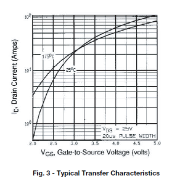

Take a look at this IRLZ44 transfer curve, which shows the drain current as a function of the gate to source voltage for a typical device. At Vgs=2.5V and Vds=25V, the device will conduct around 7 Amperes (over 50 A at Vgs = 5V). Note also the strong temperature dependence of the transfer characteristics.
This is why, for a constant current electronic load, you need a current sense resistor, voltage reference and error amplifier, as shown in the link Tom posted.

You need to become familiar with reading device data sheets, and the fact that semiconductor devices have very large tolerances in their published characteristics.
For the example I posted above, locate Vgs = 2.5V on the horizontal axis of the graph.
Read up along the vertical axis to see the drain current curve. At 25 degrees Celsius, the drain current is typically 7 Amperes. At 175 degrees Celsius, it is maybe 12 Amperes.
What that tells you is that you cannot safely control the drain current by simply varying the gate voltage, without additional sensors and information, like a current sense resistor, a voltage reference or control voltage and an error amplifier in a feedback loop. Like this:
