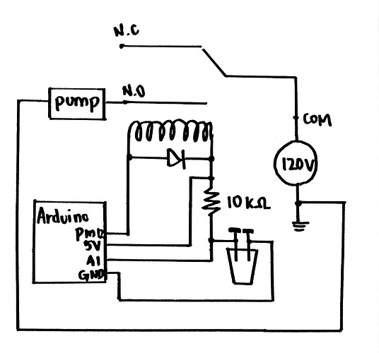

I am currently following a guide to make a self-watering plant arduino:
I am having troubles with understanding how to wire the whole circuit so I decided to draw a circuit diagram. I think in the instructions some of the steps were missing, for example, where am I suppose to connect the analog pin to? Maybe I missed that part but I went over it multiple times...
Here is a picture of the diagram I drew, could someone please point out where my mistakes are:
Also, I have a few more questions. Why is the 5V connected to one of the bolts with the red wire? What is that suppose to accomplish? Also, why do we need a 10k resistor, can't we just sent 5V directly to the coil for the relay to work?

The 10 K resistor connected to one side of the relay is supposed to be connected to the 5 volts.
So the relay and the resistor are always tied to 5 volts.
The other side of that resistor is to be connected to one of the probes.
The other probe is to be connected to A1 of your Arduino.
Note that the relay is switched on by setting its pin to LOW, so the other side is supposed to be HIGH or else that relay can't switch on like this.
Also be sure to use a very low current relay.
And ALWAYS also connect a diode over a relay coil connected to and/or near your Arduino.
Connect it with the anode to the side that is connected to the Arduino, and the cathode (the side that has the line mark) to the coil side that also has the resistor.
If you leave out this diode, be prepared to do serious damage to your Arduino.
This means the resistor is not of any influence to your coil, so your drawing is incorrect.

Your new drawing isn't correct yet.
You still have the 5 volts connected to the resistor and the resistor connected to the relay coil.
The self made sensor is also directly connected to 5 volts.
That is not what i meant,
You need to connect the 5 volts to the connection of the resistor and the coil, so to the other side of that resistor and create a T-junction.
This way the 5 volts can (and will) go up to the coil and down to the resistor.
After that, the resistor has one unconnected side.
That is where the sensor probe goes.

Okay here is my latest attempt:
Now, I don't get why we even need the second sensor probe and the 5V from the Arduino connected to the resistor. I was thinking we can just get rid of both the 5V pin and the sensor probe and have pin 12 connected to the coil which is then connected to the resistor which is then connected to the GND of the Arduino. Could you please explain what is wrong with what I just said?
Yes i can.
But first i must point you to my mistake (sorry).
I made you draw the analog input connection to the wrong spot.
The analog input actually goes to the side of the resistor that is connected to that probe.
The other probe goes to GND (and nowhere else).
That way you build a voltage divider.
The current through the coil is not controlled by this setup (if you thought that was what the resistor is for).
So if you use an incorrect relay, that current will do damage to your Arduino.
A resistor in series with a coil would not help a lot because of the nature of that coil.
That's why you would see a transistor popping up if someone over here would have designed this device.
That doesn't really reduce the current through the coil, but it would protect the Arduino from being destroyed by it.
The resistor limits the current, and is part of the sensor.
The other part is the resistance of the soil your plants are in.
This resistance varies by its humidity, and that's exactly what you want to register.
You can't really measure a resistance with an analog input pin.
You need the help of another resistor and build a voltage divider.
That is what a potentiometer is essentially too.
What you are suggesting, would never result in a relay switching, and a sensor that doesn't sense.
If it would sense, that value would depend on coil current.
Also the relay would work in reversed order if at all.
Again, sorry for my mistake.

Thanks! And no problem about the mistake. The circuit makes perfect sense now and for those who are interested this is the circuit:
Now, as for the relay... I decided to use this one:
The max current it can have is 90.9mA. And since the resistance will always be greater than 10kohms, then the current will be less than 0.5mA. Is this how you choose relays? Is my relay choice good?

Just don't be surprised when the probes corrode away in a short time. We've been over this in another thread, even stainless steel and gold will corrode with a current flowing through them, when in contact with any dampness.
The 10k resistor is not limiting current to the relay, it has nothing to do with the relay.
90mA is -way- more than any Arduino pin should be sourcing or sinking. 40mA is the maximum allowed, and you should keep it below 30mA.
If you measure it, I doubt the Arduino is even managing to bring it down to 0V. Use an NPN driver transistor. Current limiting resistor, say 470 ohms, to the base of something like a 2N3904. Emitter to ground. Collector to the relay coil. Other end of the relay coil to 5V. Change the program so pin 12 now pulls High to turn on the pump.

That is not quite "how to choose a relay".
There's a bunch of stuff you need to consider.
You've got the 5 volts coil, that should be OK.
That coil will switch on at 3.5 volts, and off at 0.25 Volts.
The coil current when operated at 5 volts, is 91 mA.
Your Arduino can supply absolutely no more than 40 mA per pin, if you use just a few pins (else less).
This means this relay is not suitable to be directly connected to the Arduino.
The contacts can switch 1 Ampere @ 120 Volts.
Your drawings show a 120 volts pump.
Do you know what current it will take ?
Or does it say what power (Watts) it is ?
