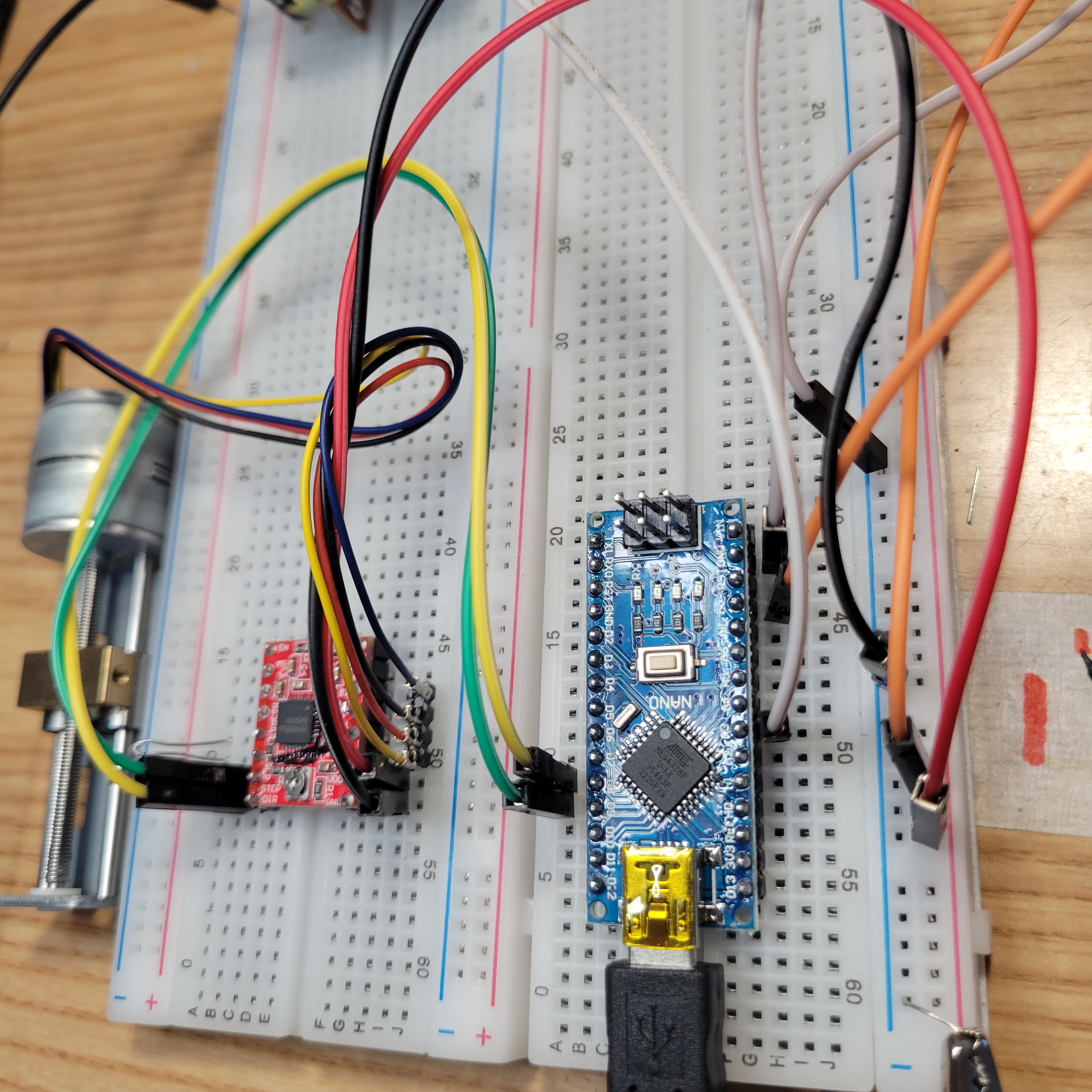

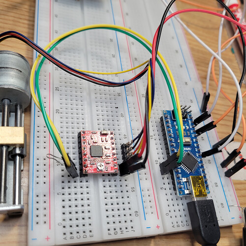

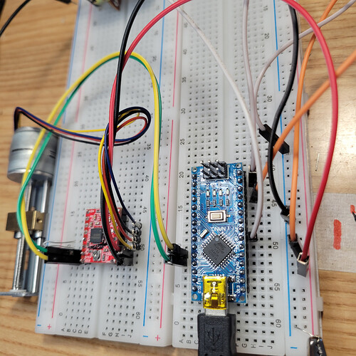

Hi, I received the linear step motor.
I loaded the program from MicroBahner and I'm getting no output to the 4 stepper motor wires.
I've tried all three a4988 I have. One was brand new and had voltage .5v across the adjustment screw.
There is some sort of activity at the dir and step pins coming in from the Nano.
All other pins seem OK according to my VOM.
I don’t know what to do next.
Here's a picture of what I have.
(ANY help would be appreciated)
I don't see any connection to the Vmot of the driver. So your stepper is not powered.

You cannot power the stepper from the arduino 5V - the arduino is no power source.
And the the Vmot of A4988 needs at least 8V to work properly - and it must be at least 2x higher than the rated voltage of your stepper - and that is 5-9V. So you need more than 12V at Vmot - als depending on the curent you want to drive your stepper with ( 200mA...600mA).
I think the A4988 isn't really a good choice for this stepper. The A4988 works best with low impedance steppers. The coil resistance of your stepper is 21 Ohm - that's not really low impedance...but you can try if the Vmot voltage is high enough.

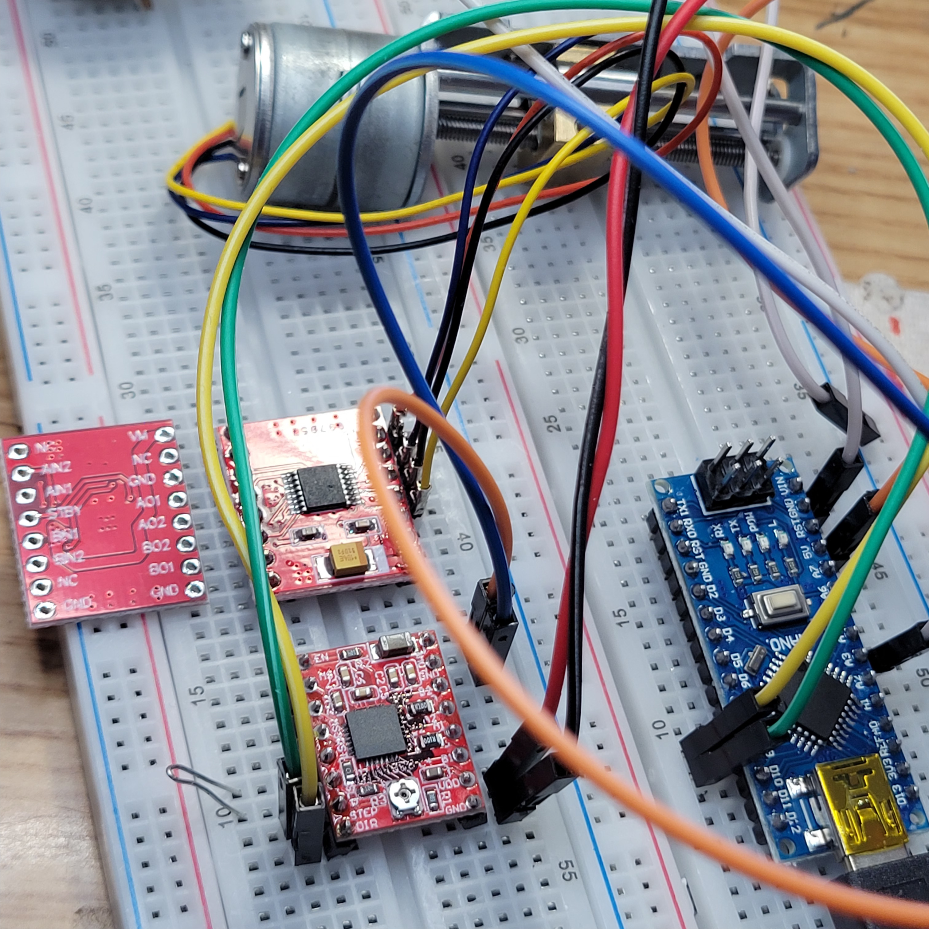

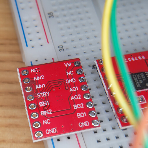

In any case you need a driver. You cannot connect the stepper directly to the Arduino. It would be possible to use a MOSFET H-bridge like the DRV8833. You can power this H-bridge with 5V - if the torque of the stepper is sufficent in that case.
Ahh,I see.
That makes the most sense to me right now.
Thank you so much.
I'm going to work on setting that up.
OK I edited my whole post, due to recent findings.
I got the new driver (drv8833). Looks like I need a+a-b+b- coming out of the Arduino.
That should be no problem, I going to try to modify MicroBahn's sketch.
