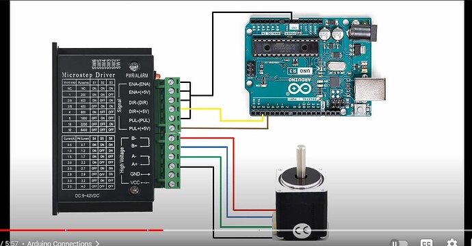

Hi i'm starting my first arduino project and i'm doing it in stages with the first stage being just getting a stepper motor working.

Thats my code and I get no errors when I upload it to my arduino.
pics of my setup
however I run my code the motor doesn't move at all. if it helps i followed this tutorial https://www.youtube.com/watch?v=nLV0fjUWI-g&ab_channel=HenryCawley
i'm using the arduino stepper library as well.
any idea whats wrong

As far as I can see from your picture you haven't connected ground of the arduino with ground of the stepper-driver.

What’s your power supply ?
I have the ground where connected I’m following this schematic https://imgur.com/a/4FnZzMA I’m kinda confused it looks like I have everything
You cannot expect a stepper motor to go from a dead stop to 10,000 steps per second instantly. I suggest that for testing to set the delays to 10 milliseconds or more to see if the motor will move.
High speeds require acceleration. The built in Stepper library will not do acceleration. I like the MobaTools stepper library. It does acceleration and is relatively easy to learn and use.
ALITOVE 5V 8A 40W AC to DC... https://www.amazon.com/dp/B078RZBL8X?ref=ppx_pop_mob_ap_share
A search of the internet seems to show that the TB6600 requires 9V to 42V motor supply voltage.
Here for instance: https://www.makerguides.com/wp-content/uploads/2019/10/TB6600-Manual.pdf
Is there anyway you could link up power supply on Amazon for me please?

Are you sure that the EN+input is LOW-active?
Do you have a datasheet or a user-manual for the stepper-driver?
What does the steper-driver-manual say?
Your schematic has no powersupply for the motor connected.
If you post a schematic the schematic should represent ALL details of your real hardware.
Without a power-supply here
of course nothing works.
