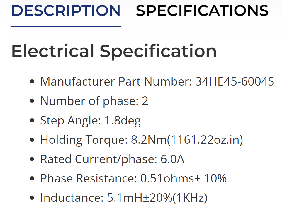

Hello, I am building a compression tester using an E Series Nema 34 Bipolar Stepper Motor (34HE45-6004S) and Digital Stepper Driver (DM860T). Since the motor has 2 phases, do I input 12A/36V or 6A/36V into the driver? I am planning on micro stepping.
Nema 34 (34HE45-6004S)
###Electrical Specification:
  • Manufacturer Part Number: 34HE45-6004S
  • Number of phase: 2
  • Step Angle: 1.8deg
  • Holding Torque: 8.2Nm(1161.22oz.in)
  • Rated Current/phase: 6.0A
  • Phase Resistance: 0.51ohms± 10%
  • Inductance: 5.1mH±20%(1KHz)

The rated current parameter tells 6A per phase. I would go for a 15- 20 Amp supply, in order to have some margin.
It's not unusual that a supply like that either delivers the voltage or the Amps, but not both at the same time !
so a 36V 15A power supply should work? I was able to find a 36V 15A power supply
Your motor needs 6A per coil with 0.51 Ohm. That means about 18W per coil or 36W for the motor. Because of losses and some safety margin a 72W PSU should be sufficent. E.g 36V/2A.
No, you need 72W, that's 36V 2A. With a high voltage the current from the PSU is much less than the coil current. The higher the voltage ( within the driver limits ) the lower the current.
How come the torque curve for the motor uses 6A?
The higher the speed, the more often the driver has to invert the coil current. But it needs time to invert the coil current. So the effective coil current will drop with higher speeds, what means lower torque. With higher voltage, the inverting of the current needs less time, so the coil current (and torque) will drop less with higher speed.
