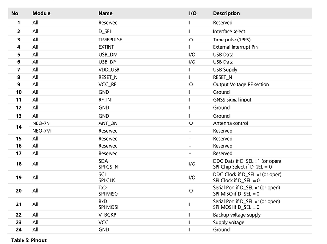

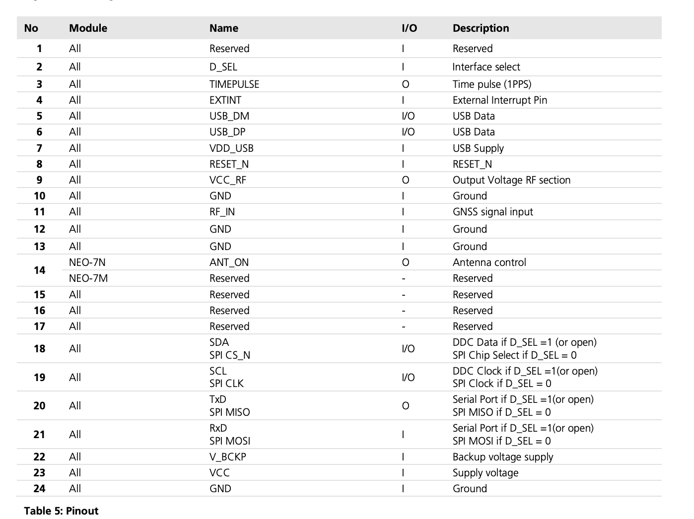

From NEO-7M the datasheet:
..."TxD" is an output from the NEO-7M and should be connected to the "RX" of the controlling gizmo.
