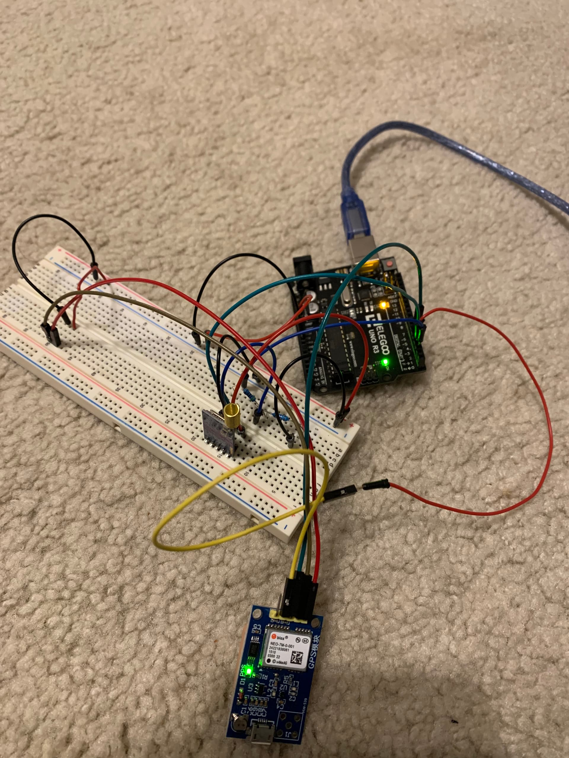

I am using a neo 7m as GPS for my project.
Getting garbage output like this:
⸮⸮⸮⸮⸮⸮⸮ repeated infinitely.
Here is the code:

Here is the picture:

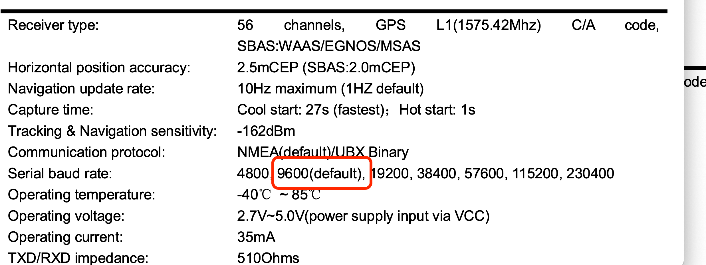

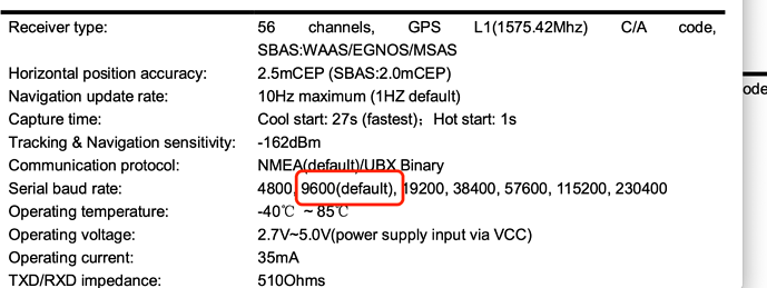

That looks like mismatched baudrates.
My NEO6-M Uses 9600 but I don't know the NEO7. Read the datasheet and check it up. It looks odd to me.

I might be wrong, being an UNO guy, but on an UNO Serial runs on pin 0 and 1 but You try to also run SoftwareSerial on the same pins. That can't work. Use pin 4 and 5 for SS, or any other free digital pins.
Software serial hardly works at that speed. I've seen here that 38400 sometimes makes trouble. Use a lower baudrate. Starting with the default 9600 is a good idea. And please don't write "urgent". That's bad. Every member asking a question is considered the same important. Using elbows is not rewarded.
I think you’re being very optimistic using SoftwareSerial at 115200 on any device.
Will not work with SoftwareSerial. As you have discovered.
and according to the image, the GPS does not seem to be connected to 0 and 1 anyway (there is nothing plugged in there)
