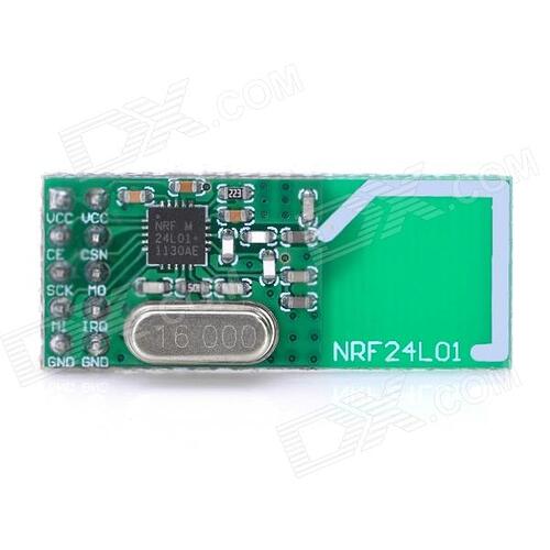

Hi there, there are two types of modules that I've seen:
http://nathan.chantrell.net/blog/wp-content/uploads/2013/08/nrf24l01.jpg
One has GND and VCC on separate ends, the other has GND and VCC on the same end, but the pins in between are the same.
The pin specification in the RF24_config.h are for softspi only, which has not been tested with the RF24Audio library. The lib uses pins 11,12,13 by default for SPI.

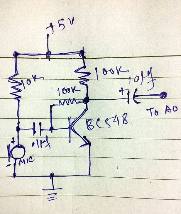

Doesn't anyone do schematics any more?

Hi Tmrh20,
I made the mic preamp out of BC548B.
I bought a class D PAM8403 based amp (very good amplification, very small circuit) board that I connected to the output.
When I connect the preamp directly to the amp the gain is quite good, but when it goes through the arduino the gain drops to less than half. Also a noise is introduced that is bearable (higher noise when powered with arduino usb) though. If I increase the arduino volume (with = key press), even one level the noise goes off, but the sound also goes off. All in all it gives best output with the default (startup) volume settings.
Any idea to get a good gain. Actually I promised my kid to make a walkie talkie out of this; To make the size smaller i bought a pair of arduino pro mini. Please help me out of this problem so that I get succeeded. Attached herewith the pre amp circuit that gives best gain for my case.
One thing I must say is that the noise response is not quite good, because when i provide computer sound output (which is pretty clean and already preamp-ed) i get a noisy output but when it directly connected to the amplifier the sound is just good. Please suggest if anything can be done to it. I am already very much grateful for the library you developed.
Thanks & Regards,
Debojit
The high pitched noise can generally be eliminated just by using a battery for a power supply. It seems to come from the computer/usb.
There are a couple of options to deal with the gain, but since you have your pre-amp already made and an amplifier connected, it might be easiest to adjust things Arduino-wise.
Problem: The RF24Audio lib uses the internal 5v analog reference. If your pre-amp is not adjusted to the right output levels, the input signal just won't be strong enough to provide good gain on the output.
