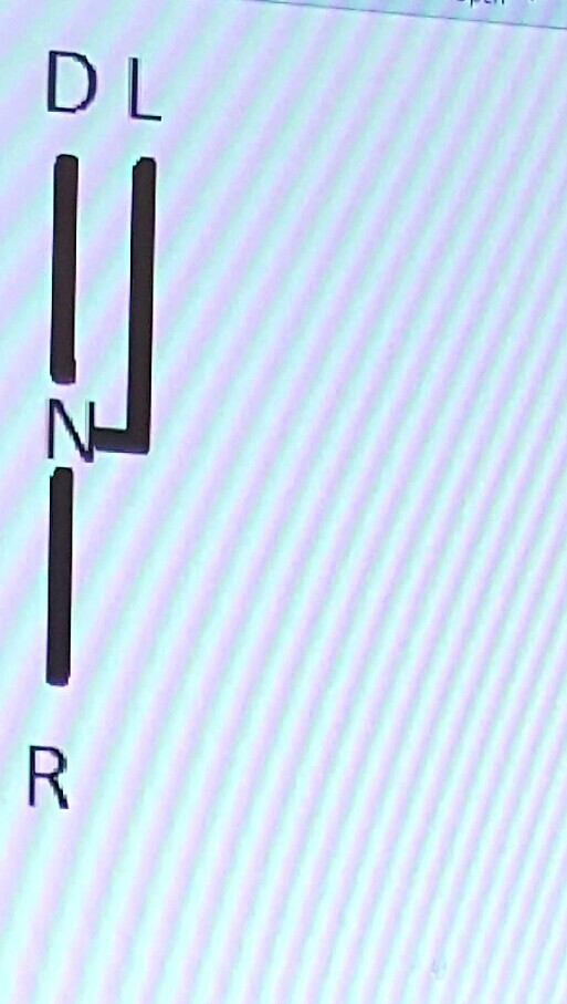

One part of this build that I am stumped on.
The ATV is an automatic transmission. It has a gear shifter lever on the right side of the ATV that has 3 positions.
Center = Neutral
forward (towards the front of the ATV) = forward gear
straight back (towards the rear of the ATV) = Reverse Gear
from center position, + Right+forward = Low gear
The ATV has an indicator for reverse, and forward, but not low gear. When in low gear, the light just indicates that you are in forward.
I want ti display to indicate that I am in Low range, or even forward and with an L in another section of the screen. So what type of sensor would work best with this? Since the stick has to move away from the atv, and up, I am not sure how a pots would work. would a proximity sensor work or something?
This is an important part of the build as leaving the ATV in low range too long can over heat things, so I do want an indicator reminding me I am in low range.

Does anyone have any ideas for a sensor that will work with the shifter to detect what position the lever is in so that it can tell the different between drive and low range? Here is a drawing of how the gears are on the atv. I need a sensor that can detect the differences between D, and L positions.

As far as the gear selector goes, a strategically placed microswitch can indicate Low Range input. To keep it inboard, it would actually indicate NOT Low Gear.
Other than that, you just need to deal with getting the 12v signals down to 5V, which isn't that difficult, but must be done
